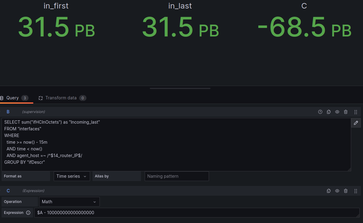

Which both returns values but when I add an expression to subtract my queries:
with number unit, the data looks like this:
Also, by testing with numerical numbers, it’s working:
So I’m basically stuck at this point…

What’s looks like a simple math (A+B) is not so simple.
Start simple math:
10 (result from query A)
10 (result from query B)
20 (expected result from math expression $A+$B)
Actually, result from query is timeseries (see query config Format as: Time series) - there is list of values and each value represent some value in time, so it can be:
10 (result from query A at 2024-01-01 00:00:00)
10 (result from query B at 2024-01-01 00:00:00)
20 (expected result from math expression $A+$B at 2024-01-01 00:00:00)
But what if those values are from different times - what should be result of math expression - I would say this is undefined behaviour, because it is not possible to do a math:
10 (result from query A at 2023-01-01 00:00:00)
There is link to Grafana doc, which is good to read:
With binary operations, such as $A + $B or $A || $B, the operator is applied in the following ways depending on the type of data:
If both $A and $B are time series data, then the operation between each value in the two series is performed for each time stamp that exists in both $A and $B. The Resample operation can be used to line up time stamps. (Note: in the future, we plan to add options to the Math operation for different behaviors).
I highlight it: If both $A and $B are time series data, then the operation between each value in the two series is performed for each time stamp that exists in both $A and $B.
Editor has feature Table view feature:
Use it and inspect/debug time series for each query and make sure you have values with right time stamps, when you want to perform math.
But I would say just don’t generate time series and it will be simple math as you expect.

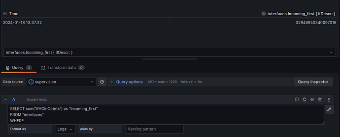

With Logs type I still get an Unknow value for my math expression and Table type returns me the erroe [sse.readDataError] [A] got error: input data must be a wide series but got type long (input refid).
By the way, I though we could only get the time of the collected data with Time Series…
Why log type? If you are only guessing, then please try also all other options there.
Well, that’s what I’ve done, I only have three options:
Time series → not working because of time
Table → returns an error
Logs → not working (and I guess because of time):
we cant remotely see your screen :stuck_out_tongue_winking_eye: so can you share error

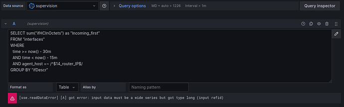

Table type returns me the error:
With the query:
SELECT sum("ifHCInOctets") as "Incoming_first"

I would say you can’t generate non timeseries result with InfluxDB - there is still time dimension in the result.
You can try to use transformation - but don’t expect easy win. You will have to figure out how to use multiple set of transformations to get expected result.
I would say the easier option can be to generate timeseries with the same timestamp, so expression will be working fine (e.g. timegrouping with long time period).
The best option is if you change the approach. Total is just area under the curve for subsequent field values - and that’s a task for INTEGRAL. More complex InfluxQL (math function, maybe subquery), functions instead of simple A-B on the Grafana level.
BTW: I guess ifHCInOctets is a counter, so DERIVATE may be useful as well.
