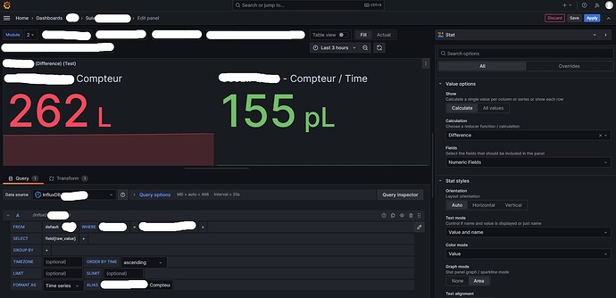

I’m sharing my request screen with you.
This may speak to you a little more
Hi @alexvasseur
You are using InfluxQL. To do math between two queries, you can use an expression or a transformation. Expressions are usually $A+$B, but then you can do $C/100. From your screenshot, it looks like you tried a transformation.
Also, sometimes Grafana (or InfluxDB) require that the timestamps be aligned when trying to add 2 values. Not sure if this is the case with your data. Maybe you can use the reducer function “Last” to get them both to be at the same timestamp?
