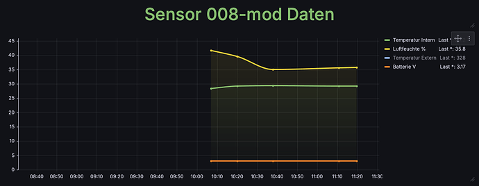

i have some Sensors that are reporting the last transmitting time. My System works like Sensor → InfluxDB → Grafana
is it possible to add the last timestamp of a receive to the value list in that graph ?

FInal output look like
