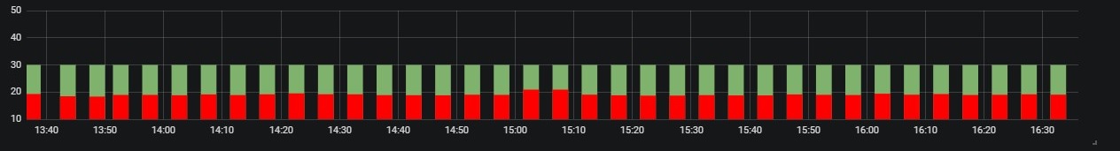

I’m running on a date shift problem between the mssql data and the GRAFANA display:
  • my database is on an MSSQL cluster :
MsSqlHeure
  • GRAFANA V6 on a Redhat 7 :
SusisHeure
I put the date time hard in my query to show all the records created after 7 o’clock in the morning, and the chart starts at 8 o’clock ?
I do not get the data of the last hour!
If you look on the day, the data is displayed from 7 am to 5.30 pm:
journee
If you look at the last 3 hours:
The data is displayed until 4.30 pm !!!
Thanks for your help… Tchicken.
