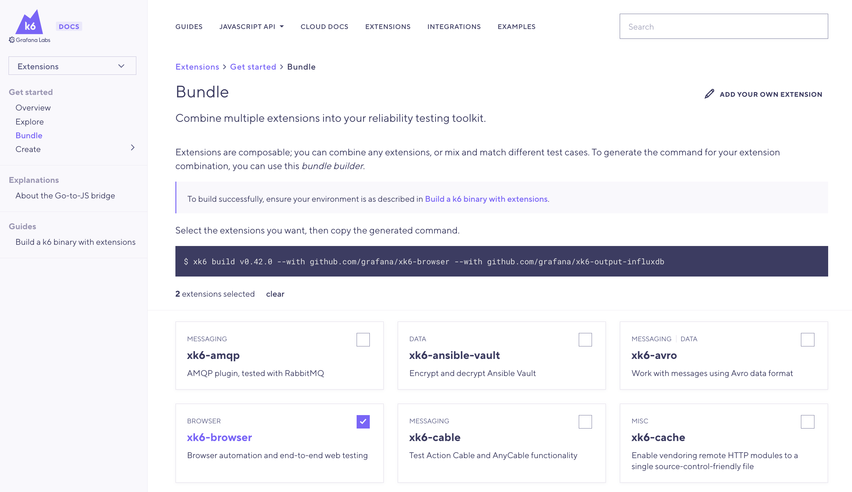

xk6-browser is currently being developed as a k6 extension. Consequently, you have to run a k6 version built with the browser extension to use the browser-level APIs in your k6 tests. And if you want to also run with the influxdb v2 extension, you would have to build k6 with both extensions.
For that you can visit k6 Bundle Builder, and check the two extensions you want to run. You’ll get the command to build the k6 binary.
xk6 build v0.42.0 --with github.com/grafana/xk6-browser --with github.com/grafana/xk6-output-influxdb
With this binary, you should be able to run both extensions.
