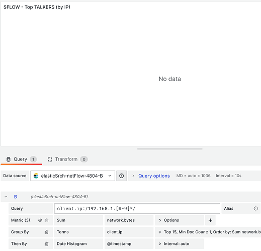

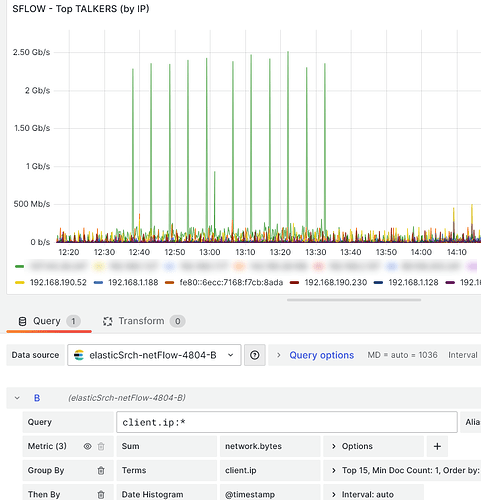

Im pretty sure im in the same boat as this poster, It’s no doubt due to my lack of proficiency in ES,
However in this image below I’m just trying to get a wild card to match any 192.168.1.*
I can get client.ip:* to match all, but no matter what I try cant get a wild card to work.
any ideas?
works:
does not work (just a few examples, to show what im trying to get, as ive tried 50+ different variations of this based on reading docs and google searches):
