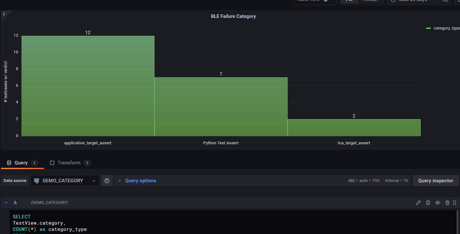

Want to automate sql query in a bar graph
I would like to automate my bar graph. Currently I’m creating a new line for each unique entry to the database. Is there a way to do this with some kind of ‘SELECT DISTINCT’?
An example of the first line is;
CASE WHEN COUNT() FILTER(WHERE TestView.category = ‘python_test_assert’) > 0 THEN COUNT() FILTER(WHERE TestView.category = ‘python_test_assert’) ELSE null END AS python_test_assert,

I tried it, and it sort of worked. But now everything has the same color, as well as that the categories don’t show up in the legend;

Well, everything is marked as category_type. Is there an override to change color of bar based on value of category_type?

I have tried all of them:/
you are right i can’t do it too…
It’s should work on label override of label column but it’s not .

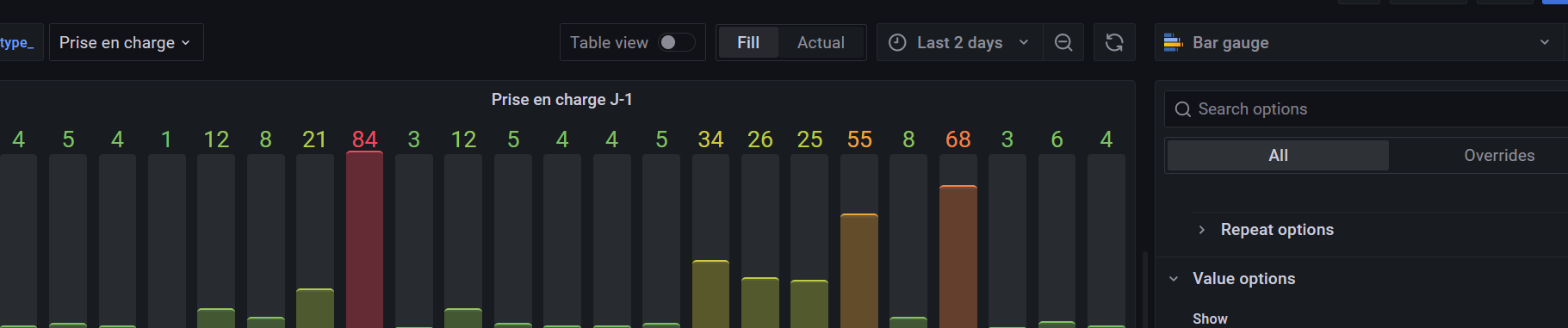

I could do it through

@yosiasz can you try to color that by name of series ? i can’t on 8.3 grafana
same here I can’t do it with Value mapping
I managed to get it working by setting the “Color by field” attribute
