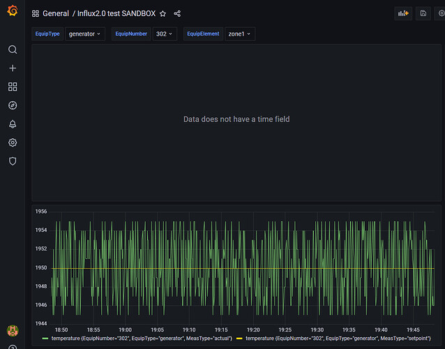

@anon70503803: I checked out the Graphite Template Nested example, and while that definitely has a great structure with variables, I do not think it is what I (and perhaps the original poster @schluk5) am seeking.
To illustrate, below is my dashboard with 2 panels and 3 variables that I configured. I want Furnace 8, Zone 1 to appear in the top graph and Generator 302, Zone 1 on the bottom graph. However, since the queries behind each of these graphs depends on the same set of dashboard variables, I cannot get them BOTH to display at the same time (only one or the other based on my choices in the dropdowns). To do this, we would need to have variables defined per panel, not per dashboard. Am I looking at this correctly?
@grant2 yep, that does clarify things for me, thank you!

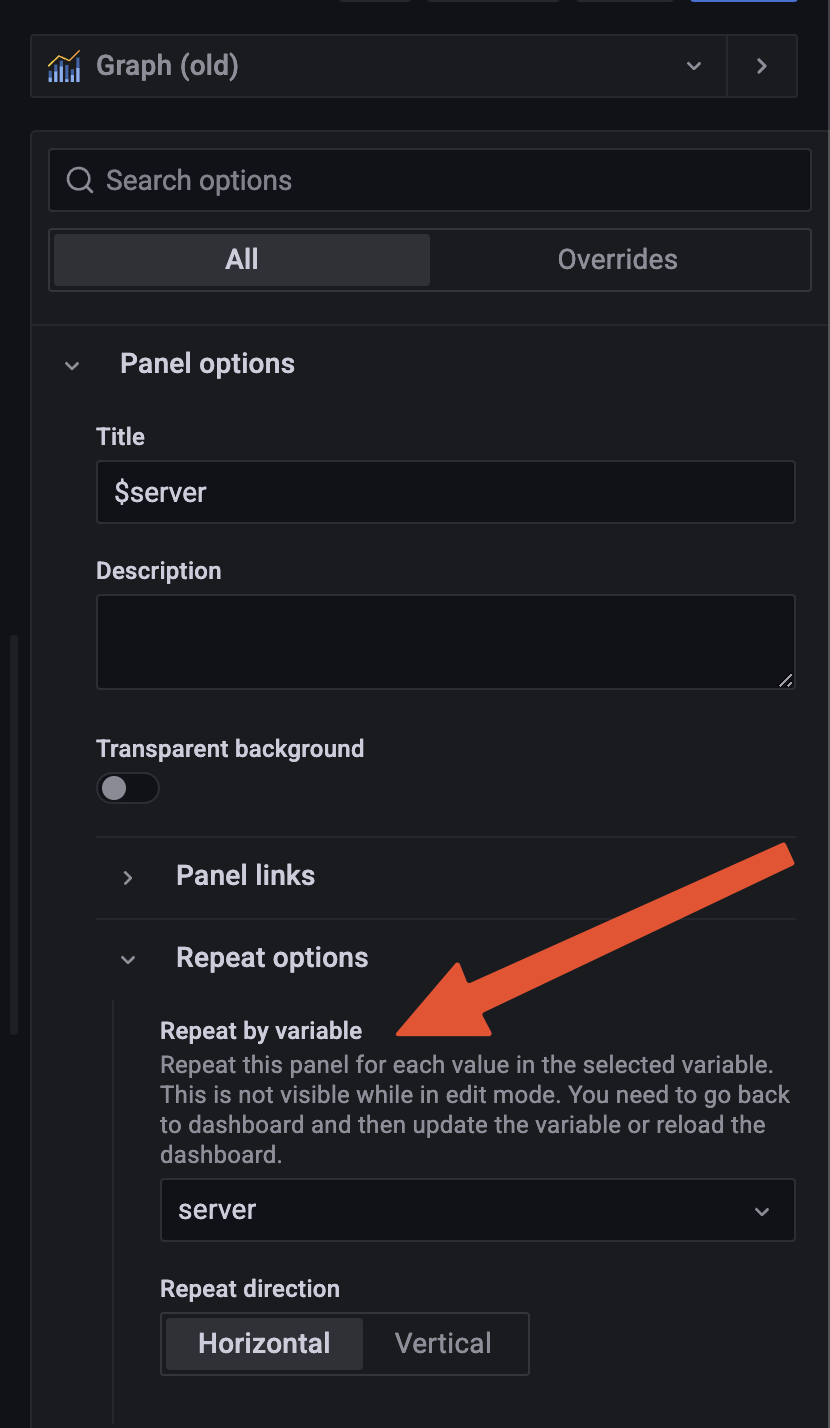

As a novice coming here for help, this thread was very useful in trying to replicate a split by series / split chart from Kibana. What I didn’t immediately spot was the “repeat by variable” option for the chart in this demo:
While this does not solve the OP’s problem, it was sufficient for my case.
