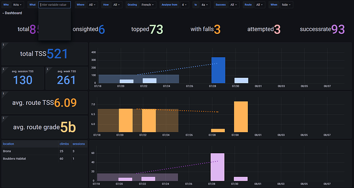

I am running Grafana v9.1.0-73288pre (046a2602ff) in a Docker Container. For a while now I have set up a Dashboard to visualize and analyse my rock climbing training.
My Docker Container updates automatically using Watchtower. Since more recent updates (unfortunately, I cannot determine exactly which update) the automatic variable population when the dashboard is loaded does not work for me any more. In the past, I loaded the dashboard and the queries associated with the used variables would execute in the background and populate drop down menus, so variable values could be chosen to look into the climbing data. For example, I was able to choose between “all”, “climbing” or “bouldering” data when the dashboard was loaded. But when I load the dashboard now, the variable associated with the same drop-down menu has no values. This can be seen in the next screenshot.
When I have a look at the variables under dashboard settings, I can see that there are no values associated. When I manually hit the “update” button, the underlying query seems to be executed and the variable populated.
Afterwards, the associated drop-down menu is populated and the dashboard can be used as normal/before.
To populate all drop-down menus, I have to repeat the manual update for each associated variable. Then the whole dashboard is useable again.

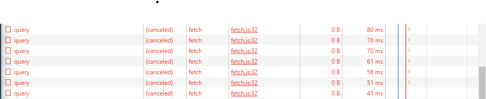

@melori.arellano I looked into the network tab of the dev tools in chrome. When loading the page, I can see some queries that are stated as status cancelled and there are errors present. These errors concern a Web Socket connection:
(I disguised my privat URL in the screenshot above)
I can export an HAR file. Would that help, or gives the screenshotted error enough information?
Edit: I saw a similar error description in this thread [Link]. Posters hinted that the correct root-URL has to be set under the [server] section in the Grafana config. I already had this URL set to my full domain (https://XYZ.ZYX.de/) for redirects to work properly. Also, I am running this Grafana Container on a Synology Diskstation and using the Synology built in Reverse Proxy. I thought I add this information for clarification, maybe.
What I also see in the network tab of the dev tools is the following query failures:
These failed queries appear when the website is loaded.
Also, when I select a value for a variable X in a drop-down menu, that should trigger a query for variable Y to repopulate the variable Y according to the value selected for variable X, I can see a failed query in the network tab dev tools:
When I navigate into the entry in dev tools under response, it says “Failed to load response data: No data found for resource with given identifier”. Which I find weird, because I can manually trigger those queries fine (as describe above), so the data is definitely there.
