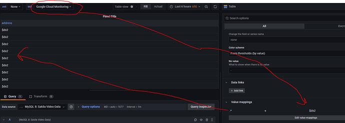

Step by step:
  1. Create a dashboard
  2. Create a variable
  3. Use this variable in Value Mappings to replace the corresponding regular expression
In play.grafana.com, I don’t have permission to create a dashboard.
