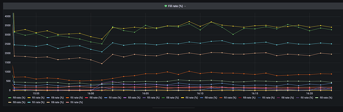

I used increase() function with $__rate_interval. This query result is different from what I expected, so I leave a question.
query:
sum by(adn_id) (increase(adnsvc_adn_get_ad_method_fill_count{cluster="xxx"}[$__rate_interval]))
query inspector info:
Expr: sum by(adn_id) (increase(adnsvc_adn_get_ad_method_fill_count{cluster="xxx"}[1m0s]))
Step: 15s
As you can see in the image above, the graph is broken.
I solved this problem by setting the min step to 1m and changing the range to 1m15s.
Expr: sum by(adn_id) (increase(adnsvc_adn_get_ad_method_fill_count{cluster="xxx"}[1m15s]))
Step: 1m0s
I want to know why it became a problem when the range was 1m. What documentation should I look for?
Does anyone know why this happened?
