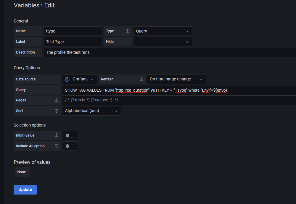

I’m using an influxql, the DB I’m using was InfluxDB 1.8. I change the option as mentioned “On time range Change”, but the data not loading also getting some errors.
The real pain point is if I hard code the value on the query it gives the results, but when I initiate through the variable it didn’t show results.

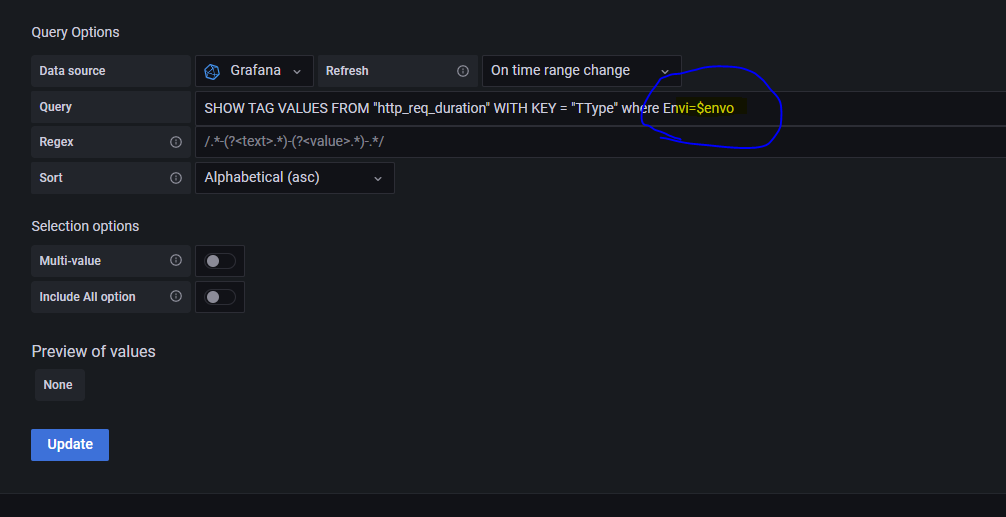

Maybe add some bracket around your var like i did on my screen, i’ think you will need son quote too like “${var}”

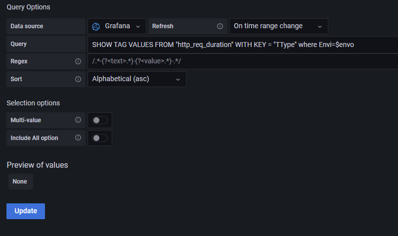

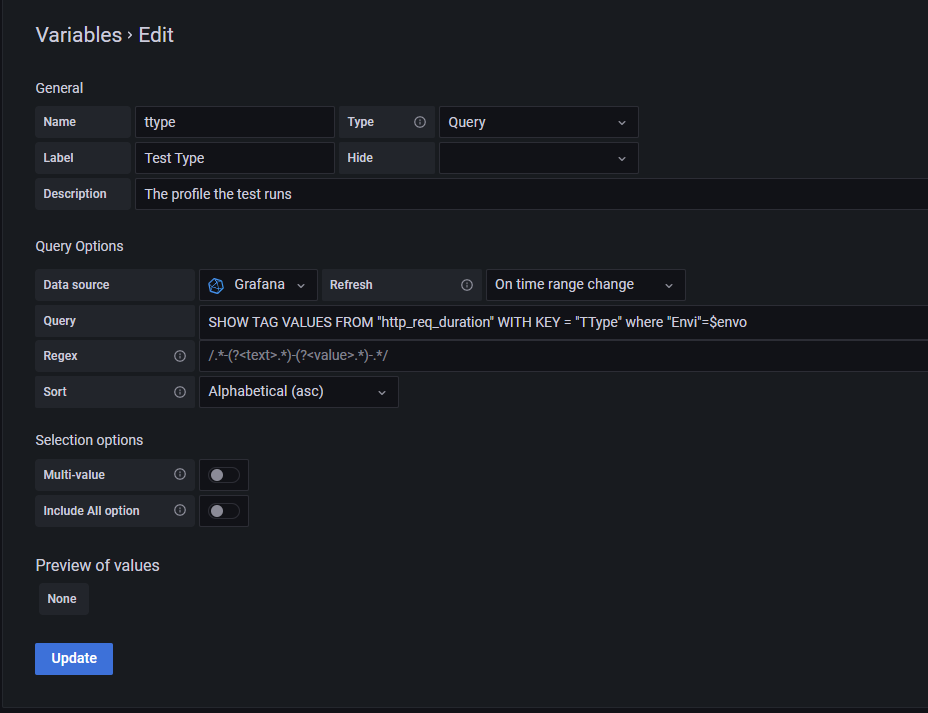

Tried but no luck. Please find the snippets.
The envo variable
the ttype variable
