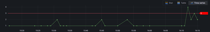

    Setting up an alert based on Loki data source, which would alert if the value is 0.
    Using unified alerting tool, passing the necessary query below and using a classic alert conditional.
  • What happened?
    Query doesn’t take in consideration “no data” values and doesn’t stack them properly, where “no data” would equal to a 0. As you can see in the screenshot below, data points are directly connected and there is no data point present when the query doesn’t return data.
    Where query provides no data it should be an option to transform it to 0.
  • Can you copy/paste the configuration(s) that you are having problems with?
sum(count_over_time({namespace="$namespace"} | json | source="$source" | type="$type"[1m])) by (app)
When there are no such events to fall under the query above, query returns no data. Once that happens Grafana query doesn’t take “no data” value as a separate data point, but just skips the data point all together and connects only the existing data points.
