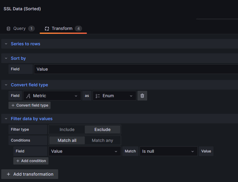

I am using the metrics query type to pull in SSL certificate exipry dates. I have the following Transformations applied:
I want to color code the rows in my Table with thresholds for red at 7 days, orange at 8-30, yellow at 31-90, and green at 91+ days from current date. Since my value is a Unix time static value which I’m scaling and converting to DateTime local, how can I set a threshold to compare that value against current date? This post seems to be basically the same issue, but how can I view/edit my actual MySQL query without seeing the query code in the builder - which I think is missing from the plugin?
https://community.grafana.com/t/threshhold-for-unix-timestamp-unit-from-now/80865
Is there a way to do have the threshold/override evaluate current date and subtract that value from my expiration value field or can that kind of thing be done with a transformation?
