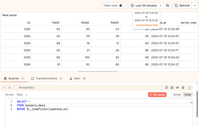

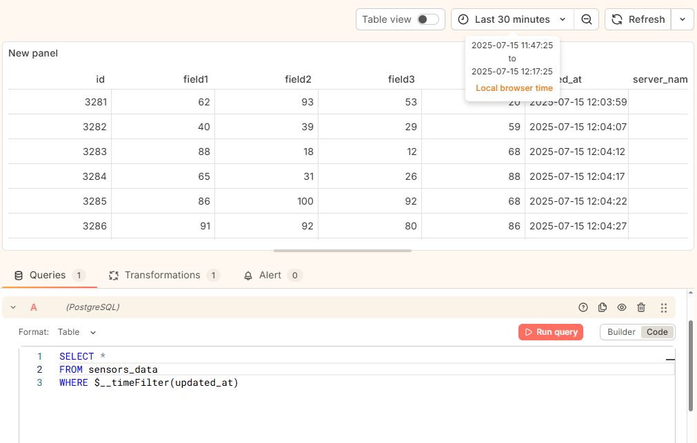

you can try this way to resolve the issue
Step : 1 add a Query for filter data based on date filter
SELECT *
FROM senser_data
WHERE $__timeFilter(updated_at)
Step : 2 Add Tranform (1 - Filter data by query refId ) apply the above writen query
Step : 3 Apply the filter using Time Range section be side of Refresh button
Final Output :

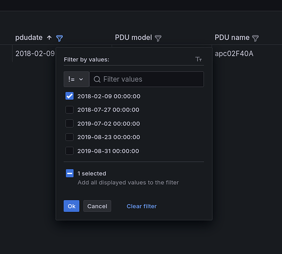

Using a time filter here doesn’t make much sense. Are you saying I should filter the “data range” by something like “2017-2021” in order to simply get a table of devices manufactured during that period?
I’m specifically looking at one column of JSON data here. I’d also like to quickly sort by devices made or installed on the same date. This seems to be a bug with the table’s filter mechanism?

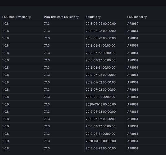

Here’s some of what I’m looking at:
!= filter does the opposite of what I want and acts like ==
This was tested in 11.x and 12.x:

"PDU boot revision": "1.0.8",
"PDU firmware revision": "7.1.3",
"pdudate": "2018-02-09 00:00:00",
"PDU Model": "AP8962"
"pdudate": "2018-08-23 00:00:00",
"PDU Model": "AP8961"

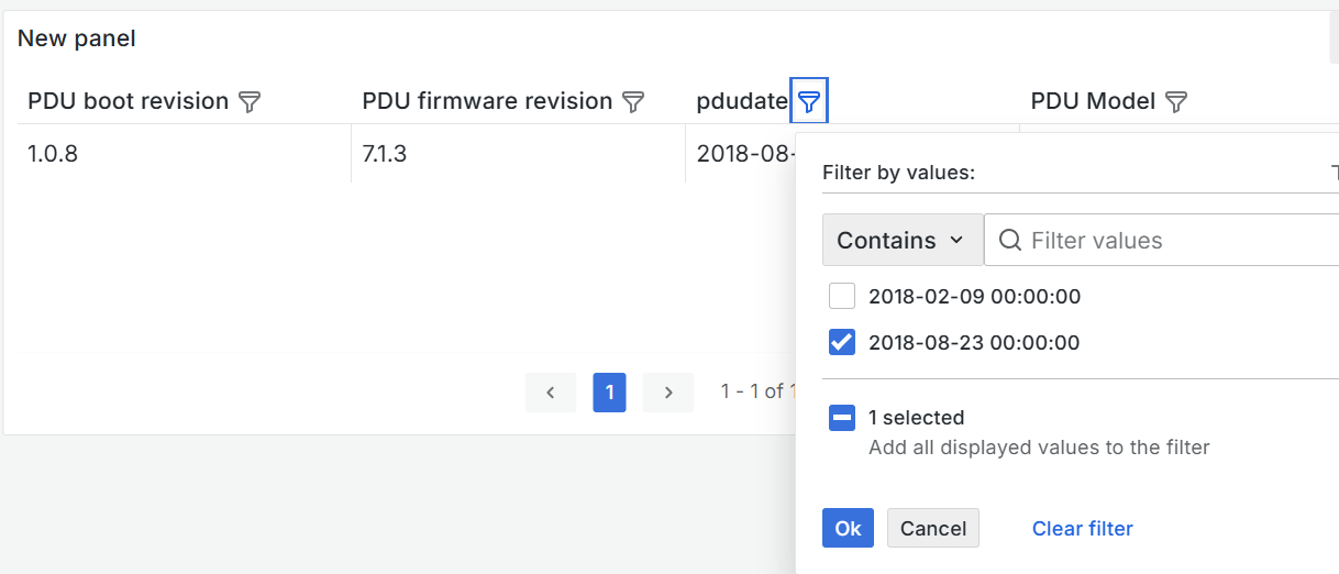

that data is similar to what I have, but the date would be a number. Contains/== are the only functions that seem to work. Even != acts like == which is strange to me. You can see that behavior in the picture I sent before.

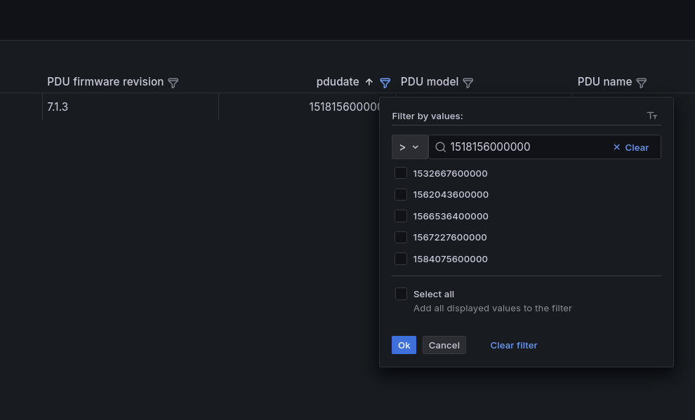

You can see here, it’s only matching one entry for >:
ah sorry! that definitely smells like a bug. I would file it on grafana github
