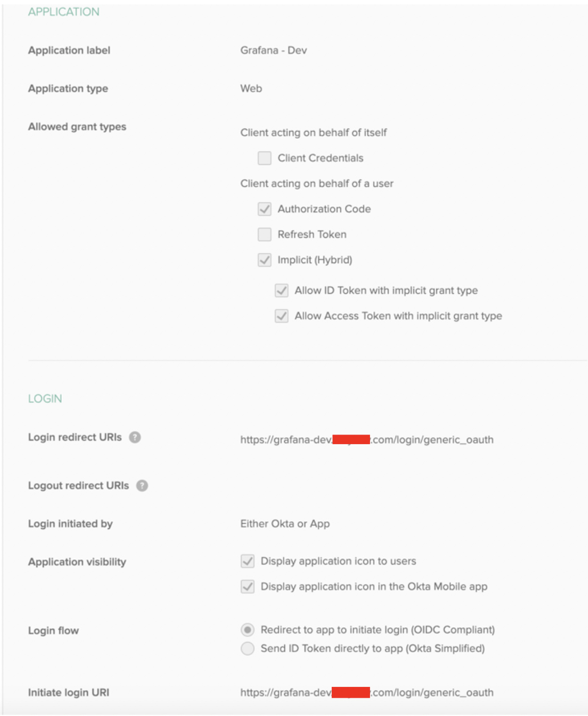

Hmm, that seems like the redirect uri might not be set properly in okta, you should check in the definition of the client in okta that it’s set to https://grafana-dev.company.com/login/generic_oauth and not https://grafana-dev.company.com/login/
(btw, i’m not an okta expert) but, I think it is configured correctly:
