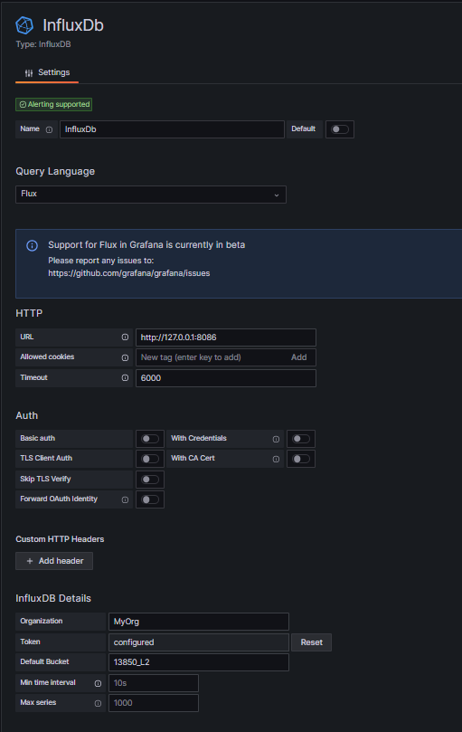

Please post an image of your connection
Hi Yosiasz
I have tried these two scenarios plus I have tried with a url http://localhost:8086
Regards Chad

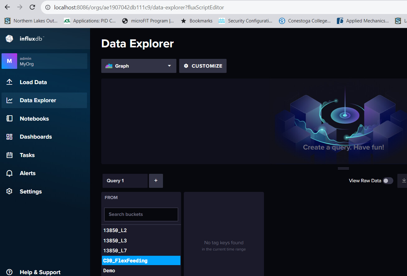

This image is from an edge device that is working with Influx and Grafana. The version of Influx is the same but Grafana on the Edge device is v9.1.0. I don’t have the server option in the newer version of Grafana? Is that because its no longer required or is there another config somewhere that enables that field? I did try the skip TLS Verify and get the same result (see below)
I have also tried with and without a bucket. I have confirmed the syntax of the bucket matches that of whats in the influx db

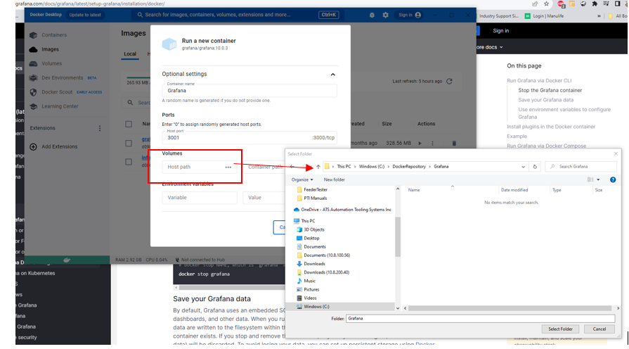

For Grafana u pulled the docker image in then opened the image from docker for desktop
