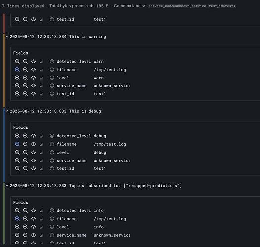

I tested it, seems to work. Here is my setup
Sample logs:
[12:25:13 INF] Topics subscribed to: ["remapped-predictions"]
[12:25:13 DBG] This is debug
[12:25:13 WRN] This is warning
[12:25:13 ERR] This is error
[12:25:13 FTL] This is fatal
[12:25:13 TRC] This is trace
[12:25:13 CRT] This is critical

Result:

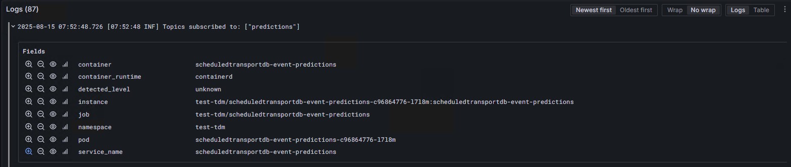

In the alloy logs:
ts=2025-08-15T07:56:30.592946093Z level=debug msg="extracted data did not contain output source" component_path=/ component_id=loki.process.pod_logs
I can’t be sure that the log corresponds with the screenshot but that’s pretty much all there is in the logs.
