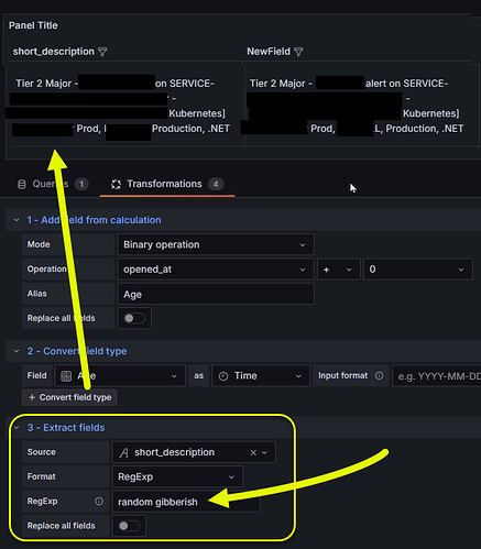

I have a short description field from a ServiceNow Incident query and every value in it always starts with Tier 1/2/3/etc… I want to create a new field from it that just has the Tier 1/2/3/etc… from the beginning.
So, seems simple, right? Use the “Extract fields” transformation with “RegExp” as the Format and “(Tier [0-9])” as the value. But nope. The New field it creates just has the entire short description value in it.
As a matter of fact, no matter what I put in the RegExp box, it just creates a new field with the entire, unedited short description value… I can just put random characters in there and it doesn’t do a thing.
And if I put forward slashes at the beginning and end of the regex expression, then I just get no new field, even if I put in the exact text like “/(Tier 2)/”.
I can take the exact same regex that I put into Grafana in any Regex tester site (like RegEx101 or RegexPal) and it works just fine…
Makes no sense. Is this transformation just broken?
