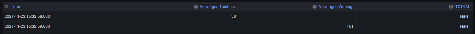

My thought was that by grouping them by 1s Grafana would be able to make a total, however, sometimes the values and the associated timestamp being returned differ 1 second or maybe even 2 although I haven’t seen that which results in the following:
How do I make sure that no matter when the value was being generated, grafana always adds them both? Because that would also remove the need for grouping them since I can just select last.
