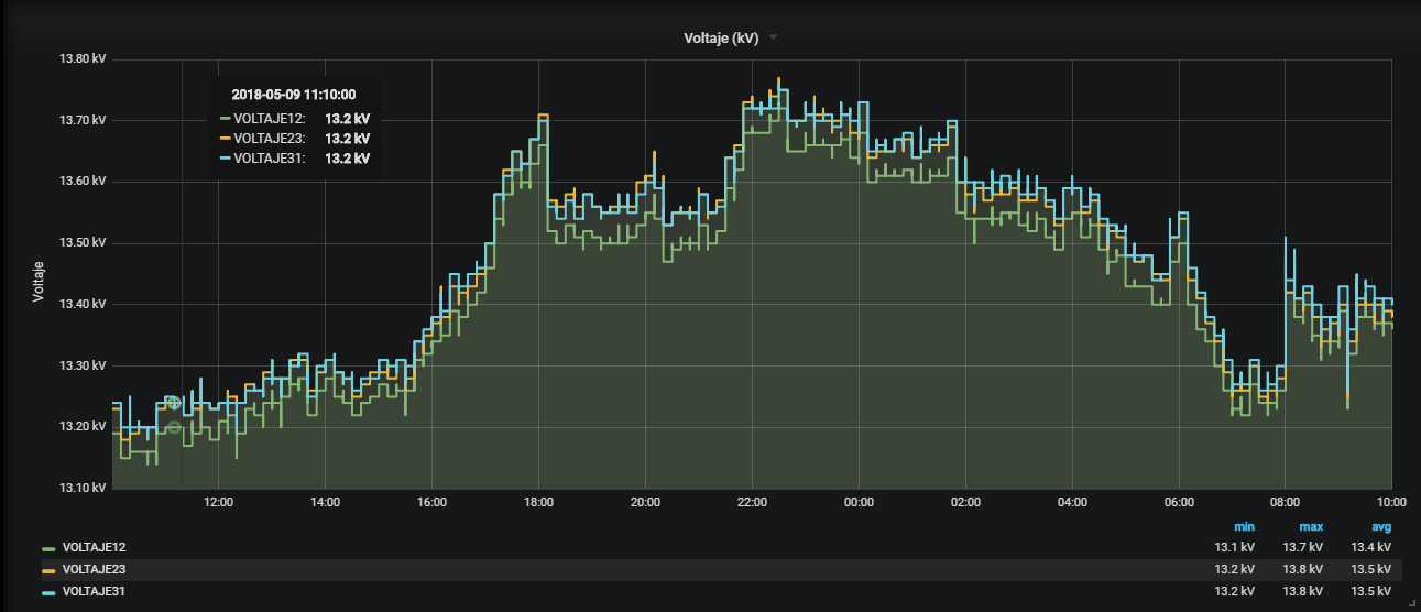

What do I expect?
i expect that the dashboard look always like:

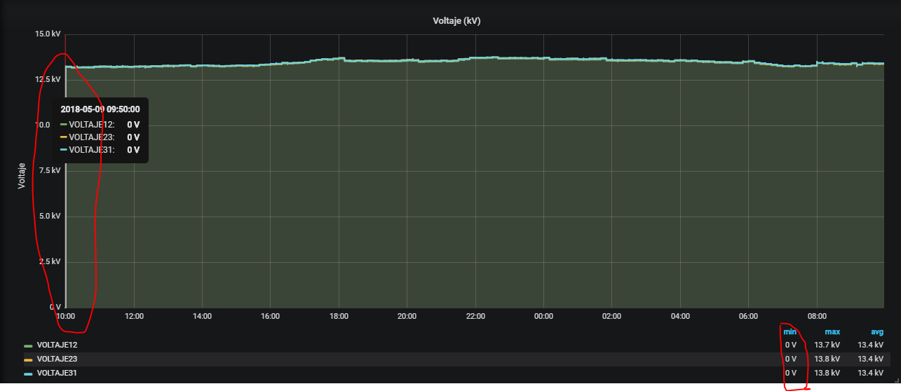

sometimes i get a dashboard that looks like:
in the last picture, you can see that auto-axis does not work properly, this is because, the $__timeGroup macro add a data-point, to the start of the data set.

If you leave out the 3rd parameter it shouldnt do that. The 3rd parameter is the value that gets inserted if there is no data for that interval.
$__timeGroup(FECHA,'10m')
Yes, i know.
and i want grafana to insert values, but not in the start of the interval
i guess the problem is you dont have values in the first interval. to fix this you would have to rewrite the query to align the start of your timeselection in the query with your interval
