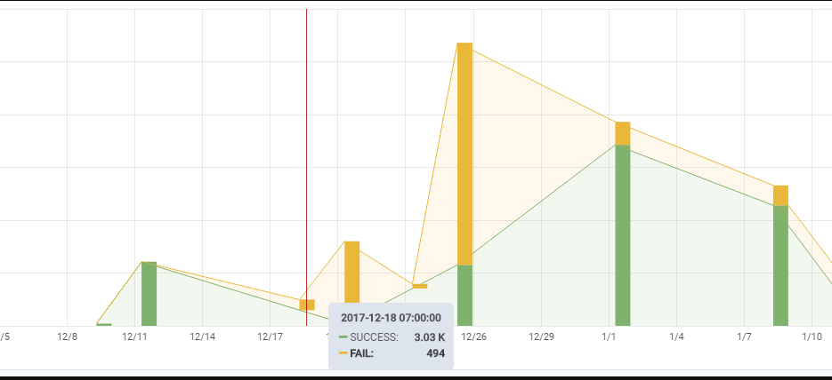

here is my display setting
I tried timezone option default/UTC but that does not help
not sure if it’s a bug
With stacked bars you need to supply a value for every interval otherwise bars will bug out. So you either need the fill option or write your query so it returns values for every interval.
