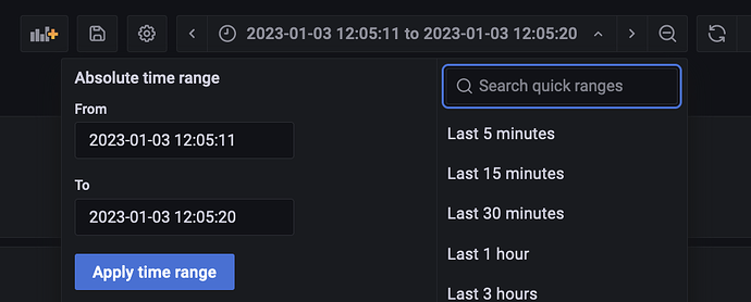

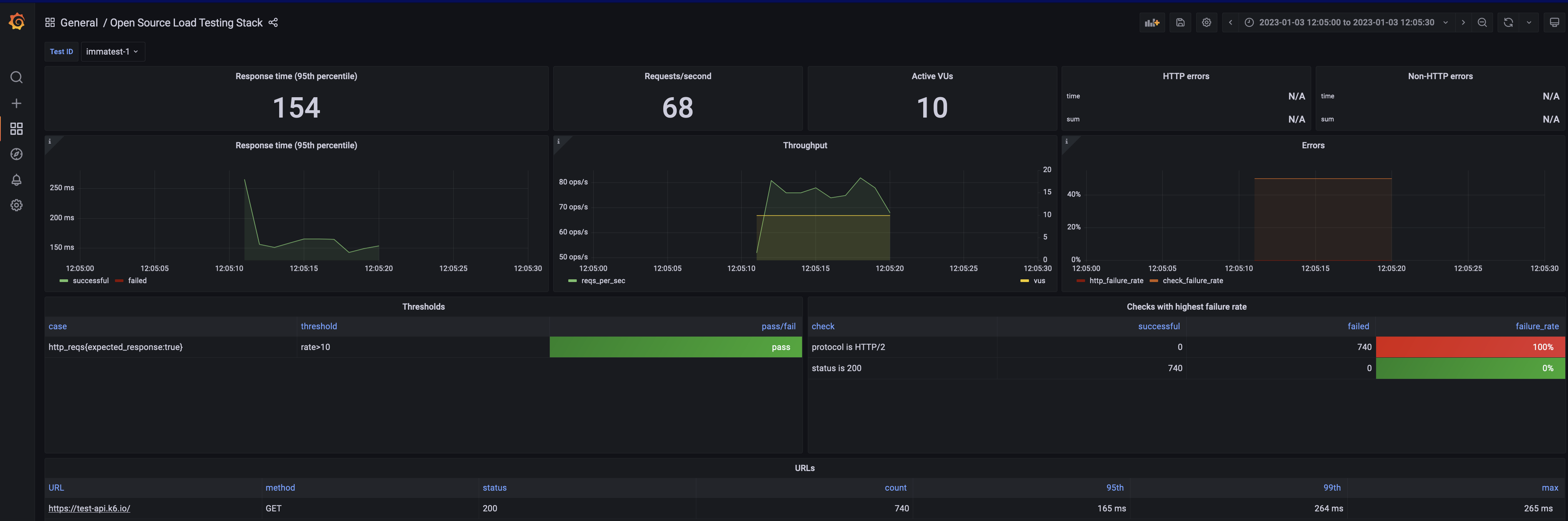

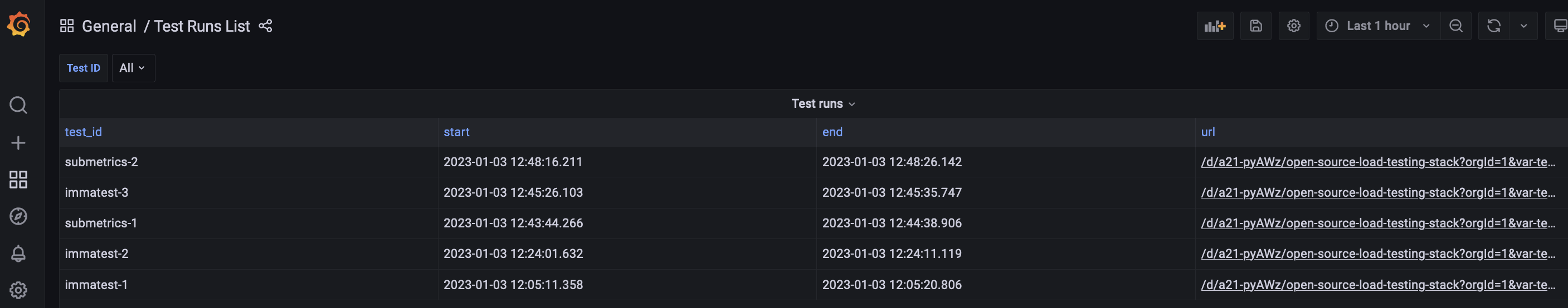

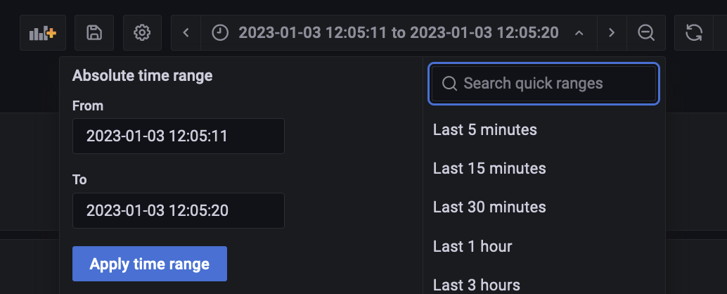

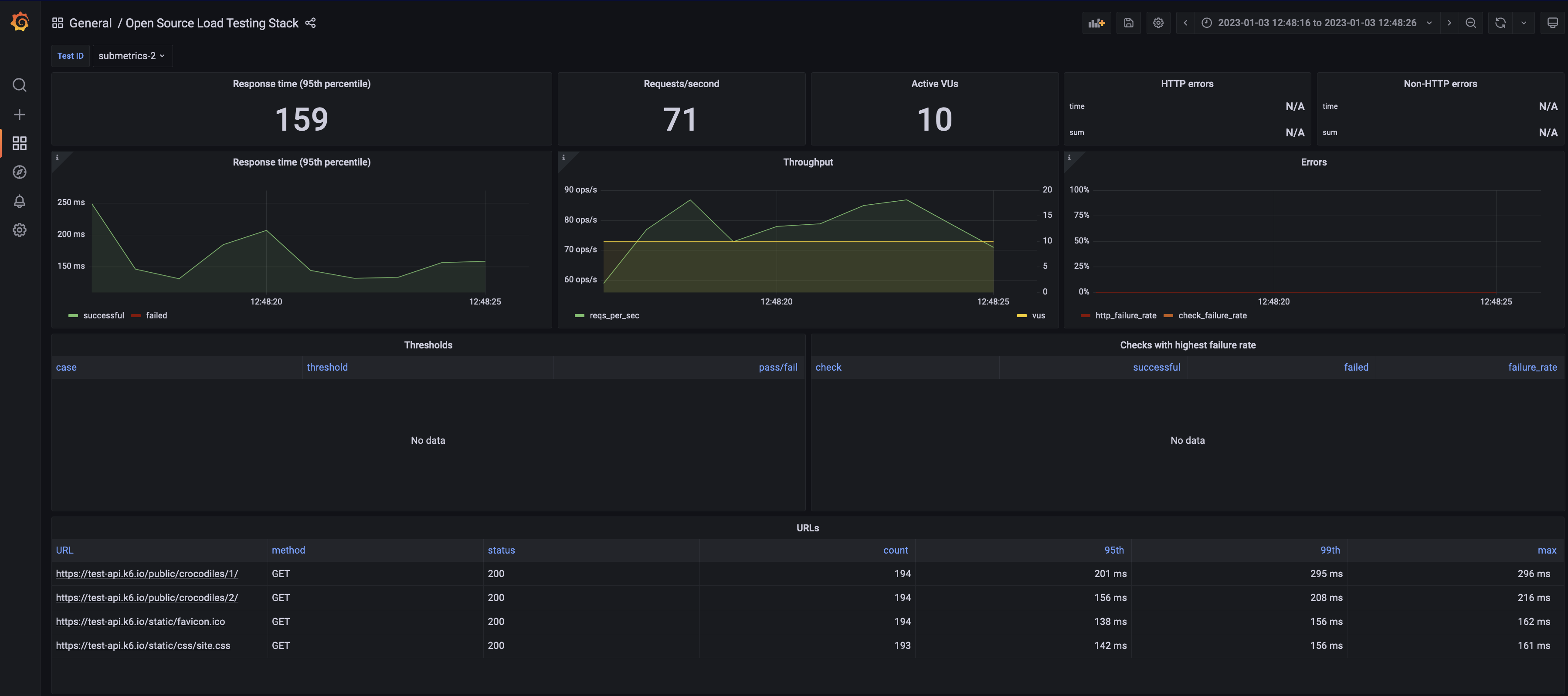

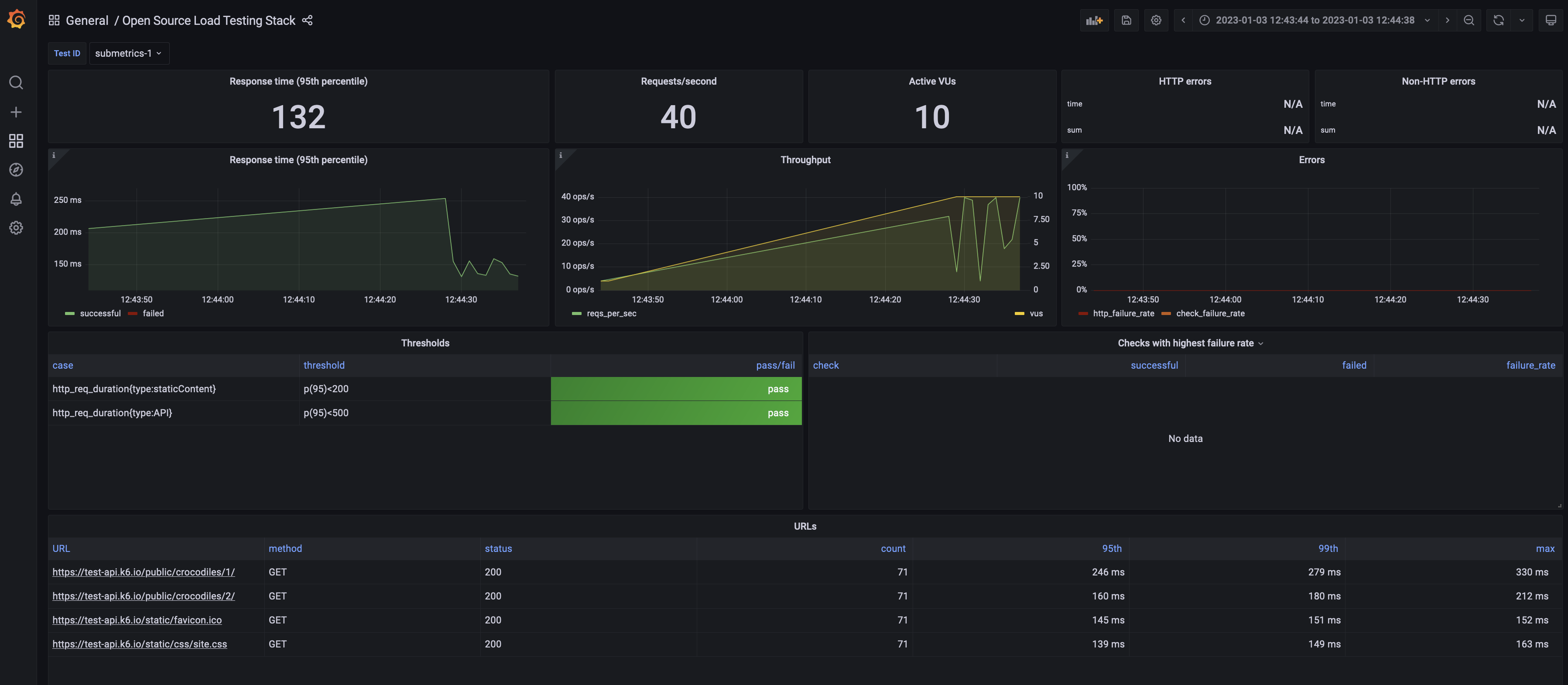

I was testing the docker compose example in GitHub - grafana/xk6-output-timescaledb: k6 extension to output real-time test metrics to TimescaleDB., and what I find in my case is that sometimes the threshold don’t show with the selected time range.
For example, selecting a test from the list:

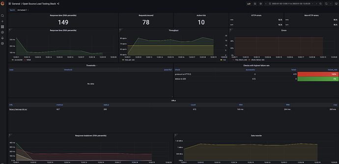

I sometimes see the thresholds are empty. E.g. for immatest-1 below it does show empty. However, it does not happen for all the test runs I tried:

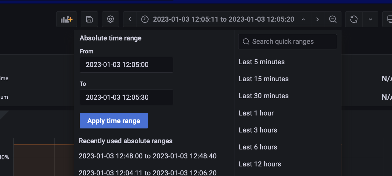

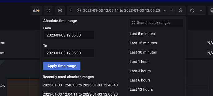

When I increase the window a bit, the thresholds show. In the example, I went from:
to:
(a very minor time range increase)
And then the thresholds appear:
Is that what you are seeing?
I did try another example with custom metrics based on the thresholds on tags example, and the same seems to happen. I need to increase a bit the time range that the test list defines.
As mentioned it does not happen for all tests. In the below test, submetrics-1, I do not need to increase the time range.
If that is what you see, I will further investigate in that direction: why the time range selected in the test list seems to bee too strict for thresholds in this panel. Just wanted to check with you this is the same issue you are reporting, or if it’s another issue that we should be looking into.

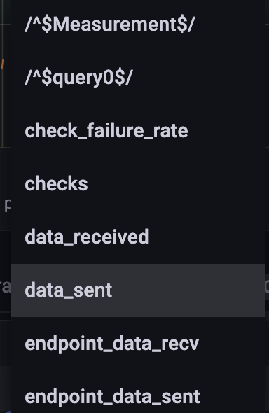

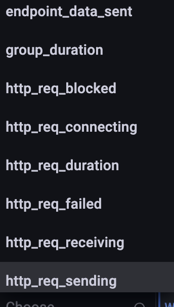

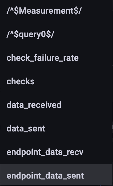

I am not seeing threshold at all which I defined in my test while trying to integrate k6 result in Grafana using influx db .

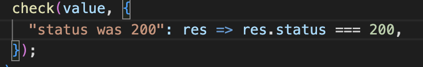

For example if i have to fetch “checks” which I mentioned in code e.g.
then I am able to see this in Grafana
but in same way when I defined threshold, I am not seeing this in Grafana
