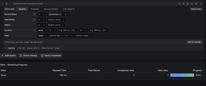

I have the same issue. deployed grafana agent on kubernetes with helm. trying to send sample trace to grafana cloud with the following command.
trace.json is from opentelemetry-proto/examples/trace.json at main Β· open-telemetry/opentelemetry-proto Β· GitHub at March 20, 2024
curl -X POST -H "Content-Type: application/json" -d @trace.json -i grafana-k8s-monitoring-grafana-agent.monitoring.svc.cluster.local:4318/v1/traces
HTTP/1.1 200 OK
Date: Wed, 20 Mar 2024 10:48:01 GMT
Content-Length: 21
{"partialSuccess":{}}
I can see the service name in grafana cloud explore section by choosing tempo.
It shows the service name in search filter. But there is no trace id in the search result. it is just empty.
No idea how to debug. I enabled grafana-agent debug logging but I dont see any useful log to understand the problem.
If the json file is invalid, is it an issue with version of OTLP/HTTP used in grafana agent?
