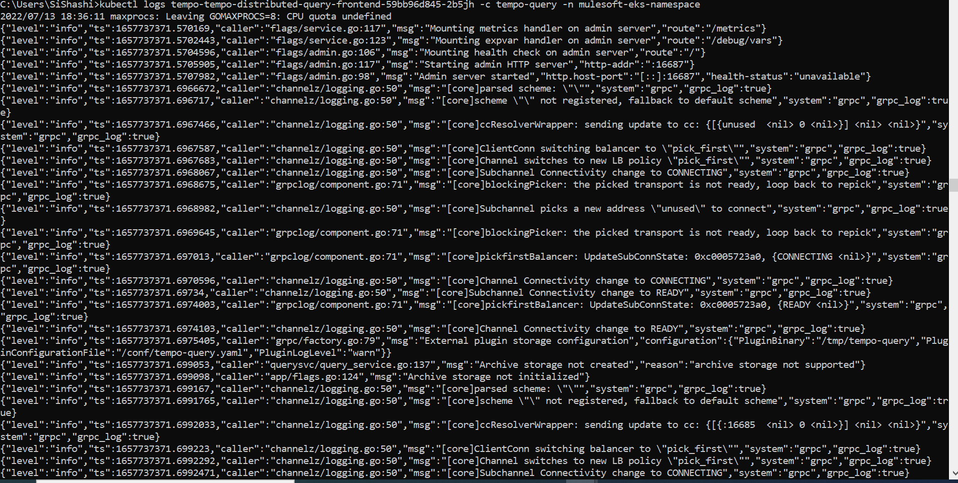

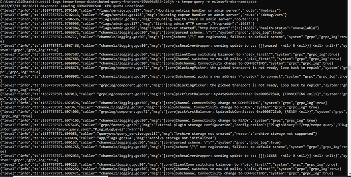

Hi,
Please find below the logs details
Hi Joeelliott,
Please find below the application log details. So you are saying we need to remove the - in events. But I think mulesoft runtime fabric is creating the ID in this format but still I will check with Dev team to change this.

The query frontend will normally log all requests at a info level, but I’m not seeing any lines indicating it’s receiving requests. Can you double check connectivity between Grafana and Tempo?

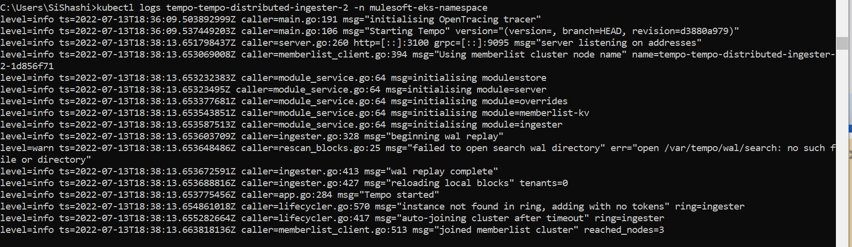

Hi Martin,
We have enabled the log_received_traces = ture .
We are using the https://github.com/grafana/tempo/blob/main/example/helm/microservices-tempo-values.yaml file to configure the tempo.
Regards,
Shashi

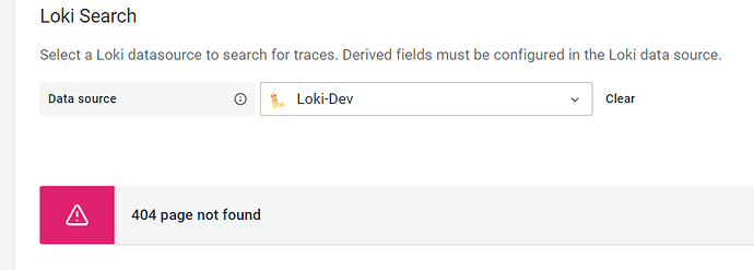

Hi Martin,
We checked with 3100 port and there it is showing 404 page no found

Hi @sbhushankr,
I think a 404 there is actually what we are expecting. This says that grafana was able to reach the service and just gets back a 404. This was an issue for a while, but has been fixed in more recent versions of grafana I believe, and if I’m reading your helm list example there, the version there is a little old.
