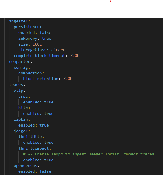

I am new to Grafana tempo(2.5.0), I have installed Grafana tempo distributed on k8 using helm charts.
I have enabled s3 storage for storing the traces and they are getting stored and I can see them.
I have also, added Tempo as a datasource in Grafana- connection test is successful.
But when I try to see any traces in Grafana dashboard- it shows nothing.
Below are the logs of ingestor/query ::
ingestor logs-
level=warn ts=2024-09-02T11:41:39.707274717Z caller=instance_search.go:71 msg=“block does not support search” blockID=747e6d88-ed7a-436f-8396-safkhjasdf
frontend-query logs-
caller=handler.go:133 tenant=single-tenant method=GET traceID=33c345441618fc28 url=“/api/search?q=%7Bduration%3E1%7D&limit=20&spss=3&start=1725255698&end=1725277298” duration=11.453819ms response_size=0 status=500
level=warn ts=2024-09-02T11:41:39.714334342Z caller=server.go:2136 trace_id=33c345441618fc28 msg="GET /api/search?q=%7Bduration%3E1%7D&limit=20&spss=3&start=1725255698&end=1725277298 (500) 11.750627ms **Response: "unsupported**\n" ws: false; Accept: application/json, text/plain, /; Accept-Encoding: gzip, deflate, br, zstd; Accept-Language: en-US,en;q=0.8; Priority: u=1, i; Sec-Ch-Ua: "Chromium";v="128", "Not;A=Brand";v="24", "Brave";v="128"; Sec-Ch-Ua-Mobile: ?0; Sec-Ch-Ua-Platform: "Windows"; Sec-Fetch-Dest: empty; Sec-Fetch-Mode: cors; Sec-Fetch-Site: same-origin; Sec-Gpc: 1; User-Agent: Grafana/11.2.0; X-Forwarded-For: 192.168.0.120, 192.168.131.18, 192.168.131.18; X-Forwarded-Server: ingress-traefikv2-b7558865c-sh5xq; X-Grafana-Org-Id: 1; X-Grafana-Referer: https://monitoring.dev.net/d/c4ef519b-a77e-48f9-9b0f-7f83f8d6f398/api-traffic?orgId=1; X-Real-Ip: 192.168.0.120;
Query logs
caller=server.go:2136 trace_id=33c345441618fc28 msg="GET /querier/api/search?blockID=9ad30469-fbf3-4e5e-83a8&dataEncoding=v2&encoding=zstd&end=1725277298&footerSize=0&indexPageSize=256000&limit=20&pagesToSearch=5872&q=%7Bduration%3E1%7D&size=17856&spss=3&start=1725255698&startPage=0&totalRecords=1&version=v2 (500) 758.642µs Response: "unsupported\n" ws: false;
I am not sure, what’s going wrong. If someone has ever came across this problem in past. Can guide me here?
