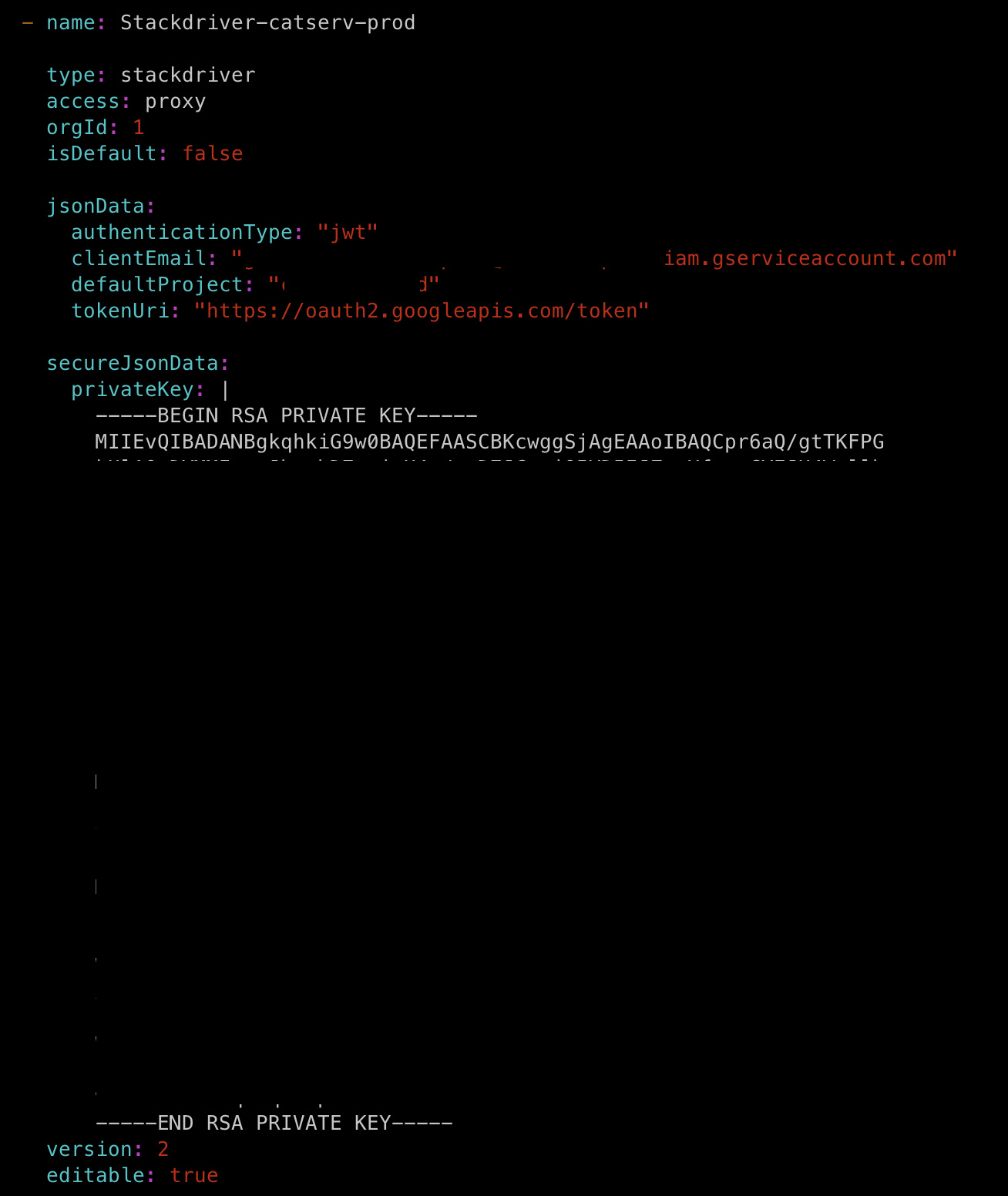

Hi together,
I just wanted to configure a Stackdriver datasource.
Unfortunately I get the following error message.
lvl=eror msg=“Failed to get access token” logger=data-proxy-log error=“private key should be a PEM or plain PKCS1 or PKCS8; parse error: asn1: structure error: tags don’t match (16 vs {class:0 tag:13 length:45 isCompound:true}) {optional:false explicit:false application:false private:false defaultValue: tag: stringType:0 timeType:0 set:false omitEmpty:false} pkcs1PrivateKey @2”
Attached you will find the .yaml configuration. Somebody an idea what’s wrong with that?
Thanks in advance!
