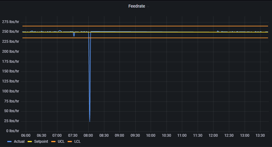

Not totally clear on your question, but in InfluxDB, in the aggregateWindow() function, the createEmpty option (which can be true or false) will change the “appearance” of null values. In the example below, the machine stopped running (i.e. actual value was NULL from approx. 8:10 AM to 12:10 PM). In both examples, I had this setting:
  |> aggregateWindow(every: v.windowPeriod, fn: mean, createEmpty: true)

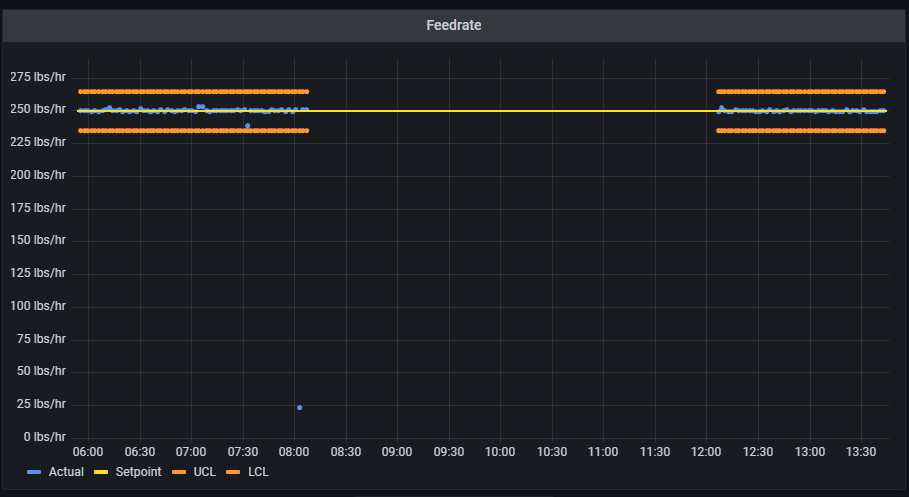

and using createEmpty: false gives this:
  |> aggregateWindow(every: v.windowPeriod, fn: mean, createEmpty: false)
