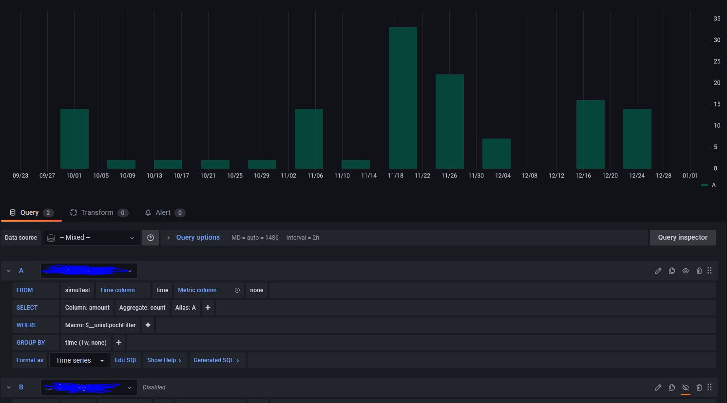

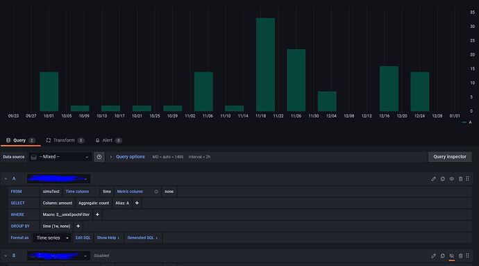

    Display the count of results from one query as bars grouped by week (“events per week”) and simultaniously display a line graph that has values for each minute
    set up two queries, used GROUP BY time(1w,none) in the Bar-Query
  • What happened?
    When only the bar query is visible everything looks as expected. As soon as I add the line query the bars get squised into vertical lines. It seems like the resolution of the line influences the width of the bars.
    queries displayed the same way without influencing eachother
Heres the bar query alone (line query disabled):

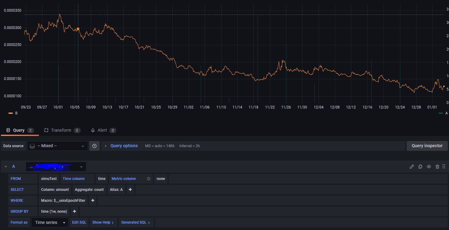

This is how it looks like once I enable the second query:
note that the bars are still there, but only have a width of one pixel

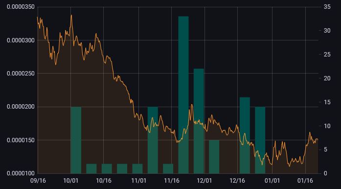

Loosing my mind trying to find a solution I gave the panel type “Graph (old)” a try and it does exactly what I was expecting.
But how can I achieve the same thing in the time series panel?

This looks like an unintended change that was introduced with the timeseries panel. It might make sense to file a GitHub issue.
The issue has been added to the 8.3.0 milestone:
