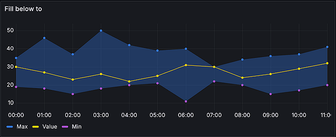

I am trying to display a panel like this one
with
in yellow the values of a “test” time series
in blue the max and in purple the min of the same “test” but on average over the last 20 weeks
In this example, “Test” would have the value 23 at 8 a.m. and the average minimum of the values of “Test” at 8 a.m. over the last 20 weeks is 20 and the maximum is 34.
