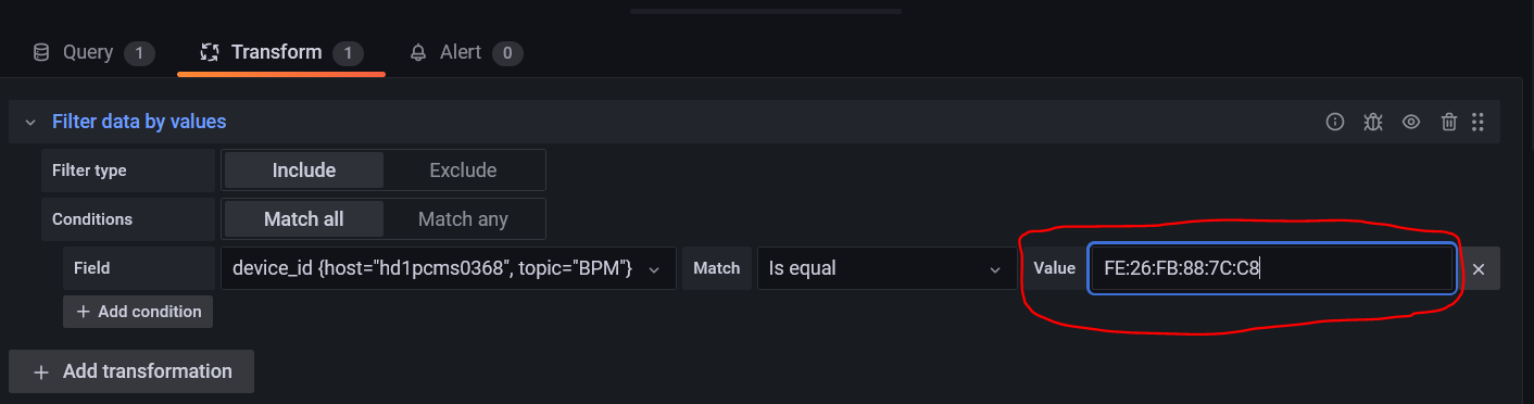

Edit: Hard coding a device value in a Transform works, but we can not use variables there:
