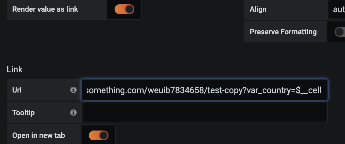

On your table panel, go to the column style options for a particular field and select Render As Link. This will open a set of Link options. Now go to the address bar of your browser, copy the whole link and paste it into Url field of the Link Options:
Now delete everything to the right of ? and replace it with ?orgID=1&var_country=$__cell&from=$__from&to=$__to.
Save and reload. If you now click on the link, you’ll come to the same place, but if you look at the address bar, you’ll have var_country set to the chosen country, which means that $country variable is now set to your chosen country.

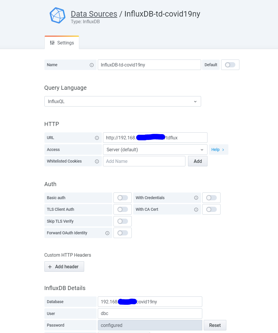

  1. Query for the right window
  1. Next - the override options - I couldn’t find Column Style, but here are the screen shots…
  1. My Data Source is InfluxDB
Pl. let me know if there is anything I can provide…

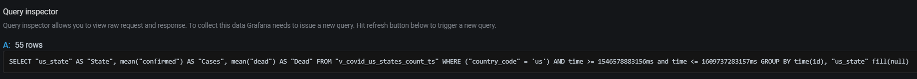

Good. I think the query is good, but the value of $state_nm isn’t as it’s prefixed with a space (looking at query from query inspector on one of the screenshots above). I think we need to look at the left panel query and see how those state values get populated and why is there a space prefix.
Left panel
Query
From Query Inspector
Query looks good. I suspect the problem in the ingested data. I recall that there’s a trim() function you can apply to the field. Do it for field us_state. This should get rid of that space.
