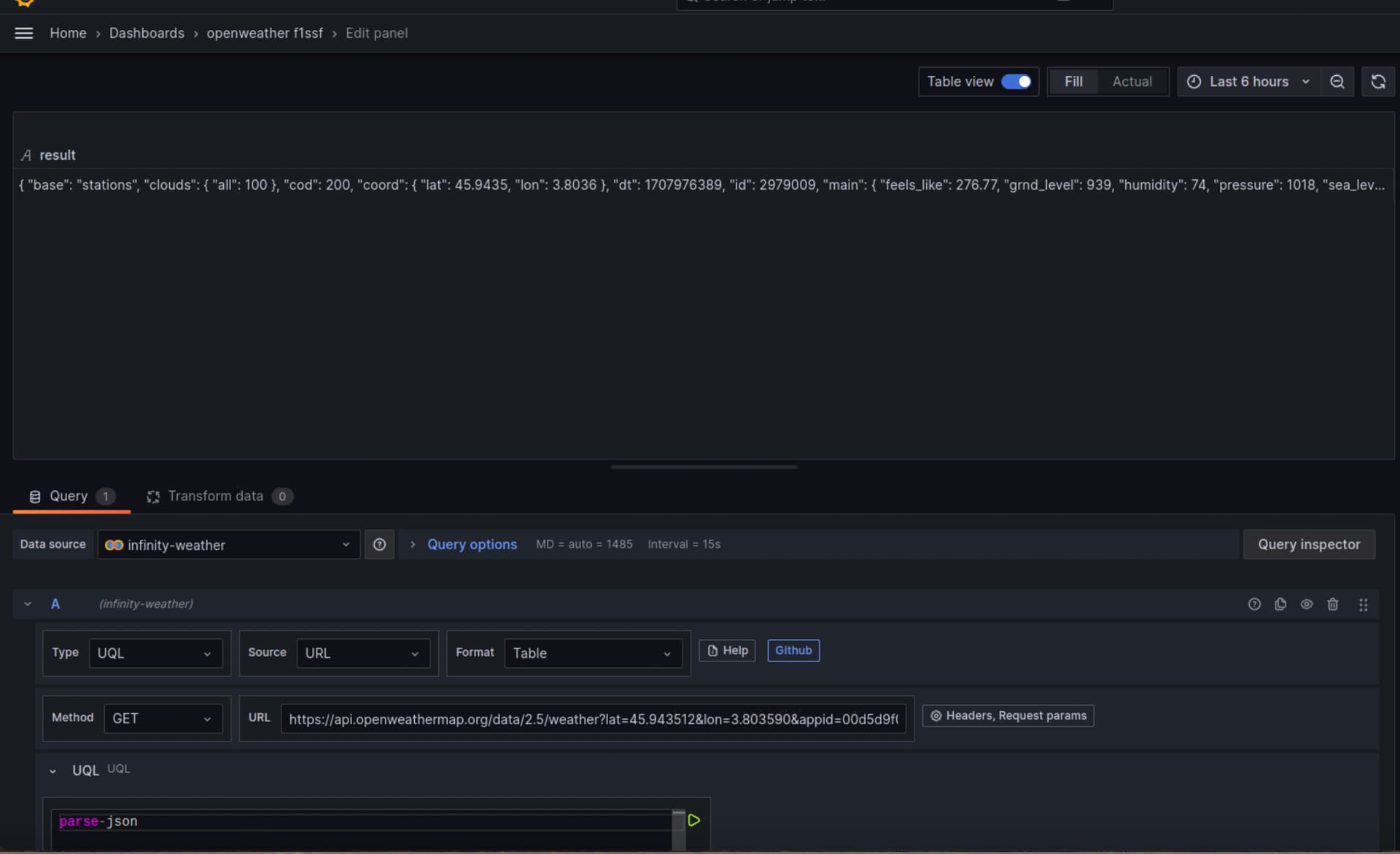

Good evening,
I’m moving forward a little. I switched to infinity, and things are simpler. I haven’t configured anything at the plugin level, I go directly to dash creation, I enter my API, and miraculously I see that the API is communicating.
Several questions please:
1> if I paste my api into the browser, I see that I have several values (clouds, temp, presure…etc)
2> in open visualization suggestion mode, I only have the ID: 804
3> I assume that you have to use Parsing options, to extract alls values to display? but I don’t know the syntax;, possible to explain to me?
Thanks a lot for your help.

yes it is exactly this :wink:
But in Source I have not result, only
try this
see result with no pars
see result with parsing main. (but if I pars with main.temp, or main.pressure, or adding others objects , propriety .)…no datas displaying
see result with UQL
thank’s for support
You forgot the transformation
In transformation, Extract field, source =>> I have not A result.
we cant see what you do have
Ok thank you to have try.
I think my problem is in my Grafana, because if I use JSON viewer on line, I can do extract without problems.
you are truly the champion of Grafana…
Oh my god sorry, I’m a beginner, it is Ok now
