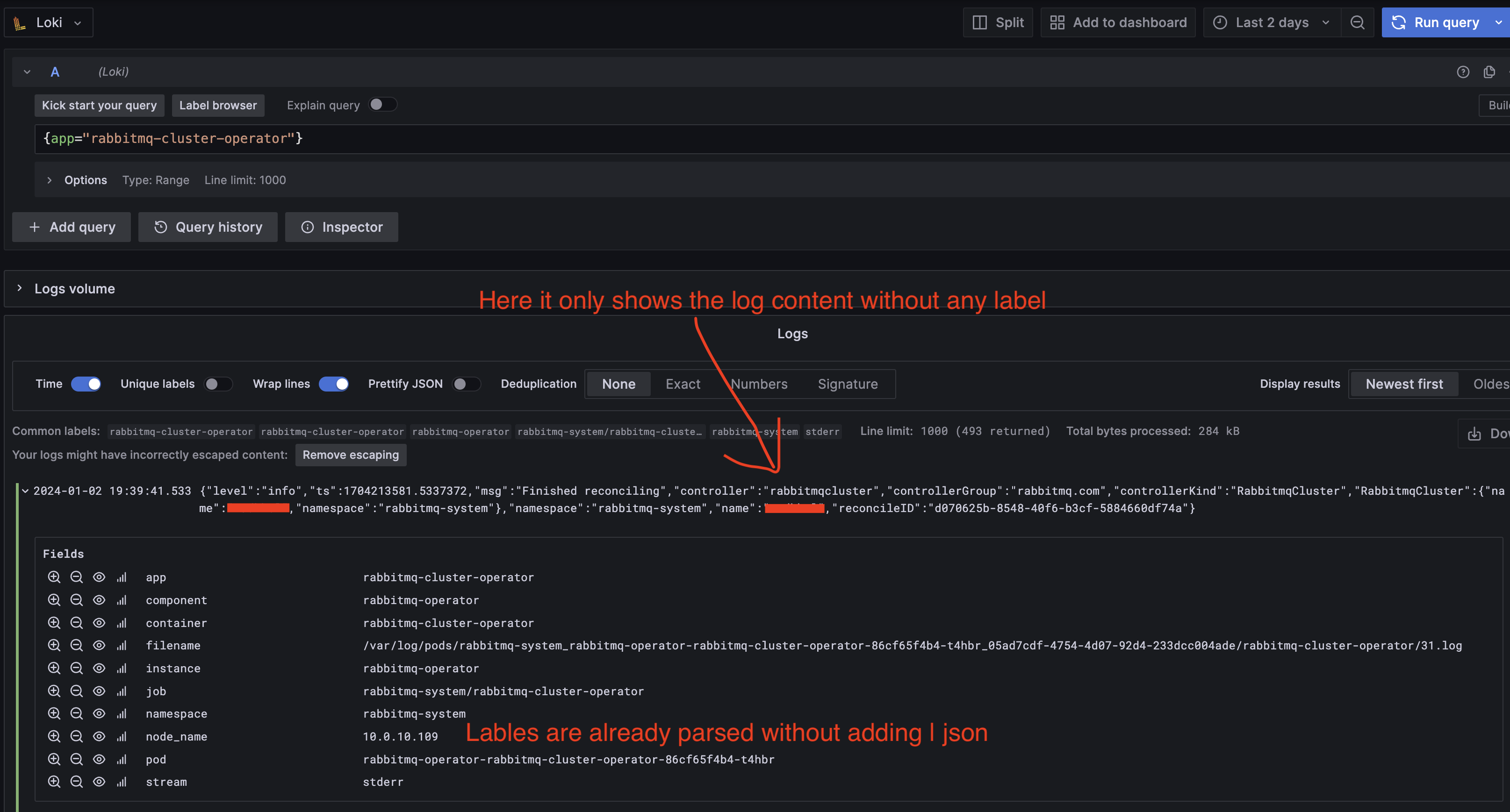

Hello, I have tried using Fluentd, Promtail and Opentelemtry Lokiexporter to push logs to Loki, both Fluentd and Opentelemtry require adding | json or | logfmt to the query to show Fields other than the Labels, while Promtail parse Fields without the need of adding | json.
I tried changing the Opentelemtry Lokiexporter log format to logfmt or raw but it didn’t help, I need to parse it using | logfmt.
This is how Fluentd and Opentelemtry show logs without adding a parser in the query
This is how Promtail shows logs without adding a parser in the query
Update: I updated the screenshots added more demonstration and I’m using default setup for Promtail, for Opentelemtry and Fluentd I tried most of the options
