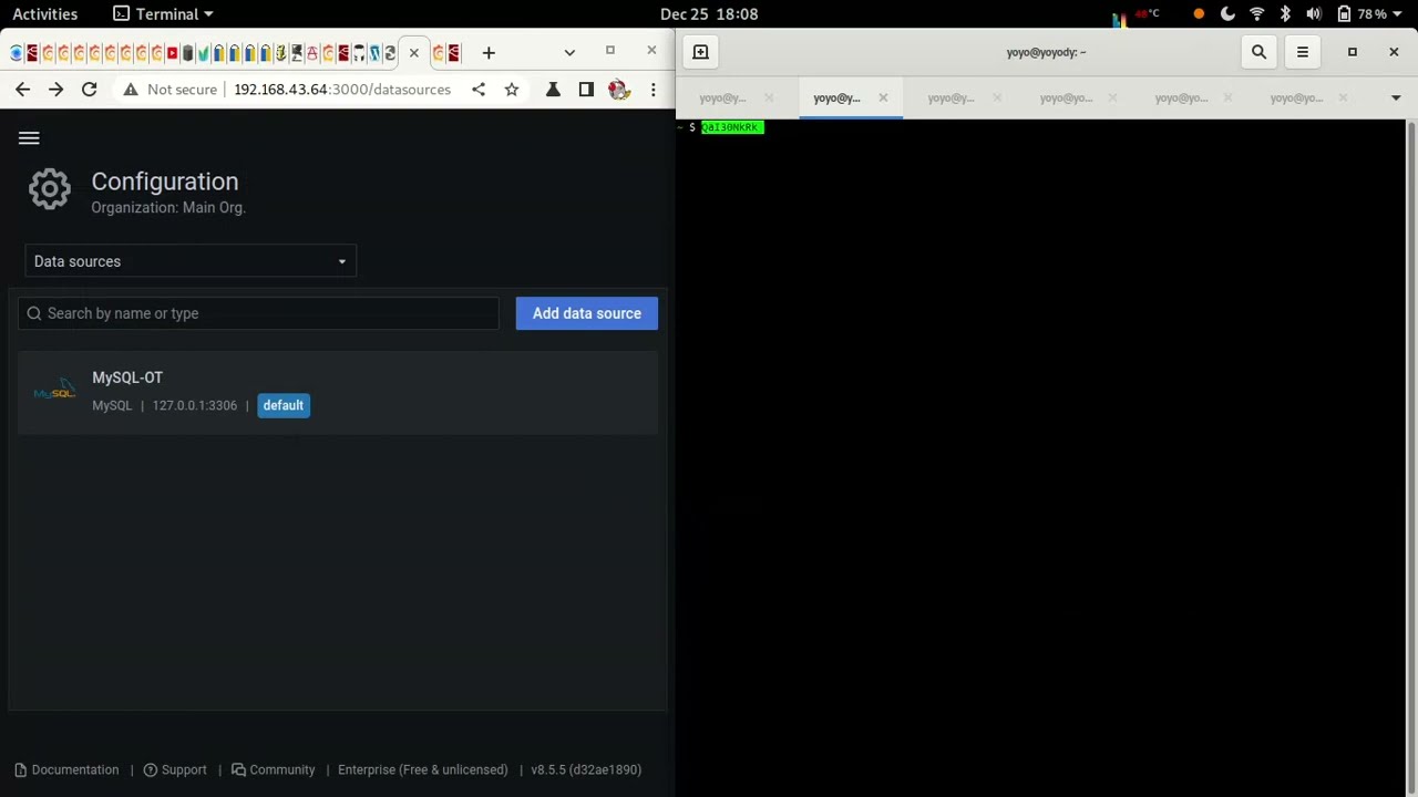

Update 0.20.5 is landed.
What a odd place to think about solutions for grafana in apt
repository. But look…
Continuation of previews post there is some progress DONE.
In this update you can:
  • building otdmMake.sh [project]
  • it’s getting predefined information from designing grafana instance
  • updating data in project directory
  • executing otdm tasker
  • executing dpkg building sequence.
  • putting ready .deb file to repository directory
  • updates directory of repository for apt
then you can see a installation process :slight_smile:
$ apt install otdm-grafana-ds-mysql
All mechanisms in this task are starting. dpkg in checking dependencies and solving them. pre post install do the magic.
And it’s… in grafana
$ apt remove otdm-grafana-ds-mysql
removes all it needs. Datasource is not there.
TBC…
let me know what you think :slight_smile:
Movie showing the process: this is on youtube → [ ybOzuR1S5To ] [ otdm-tools ver: 0.20.5 installing otdm-grafana-ds-mysql .deb ])
