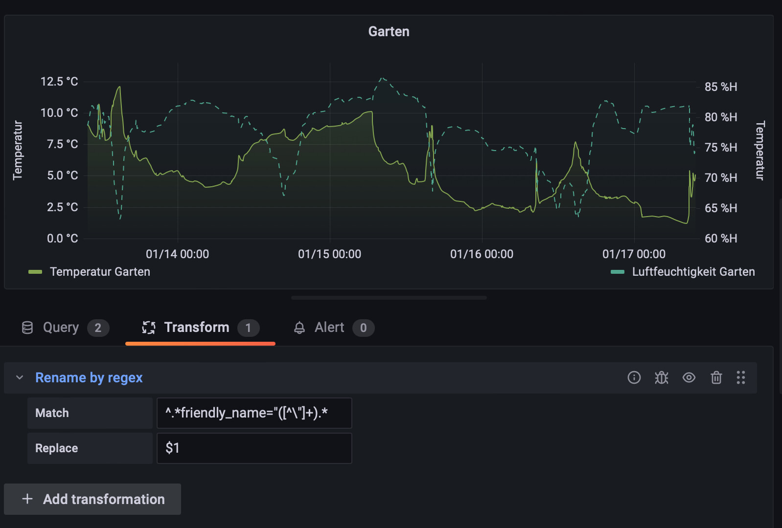

You can also use a transform of the type “Rename by regex” to solve this for multiple signals in one query.
Simply create a regex that catches the name you want as a capture group, so you can use the replacement variable $1.
In the first screenshot you see the typical crazy names that we get out of the query.
The second one shows the transform and the result.

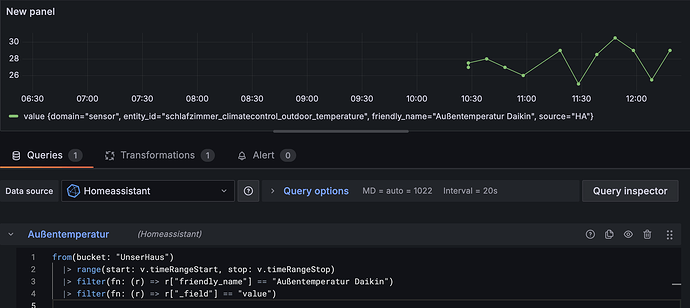

I tried to rename with Regex but it does not work. I`m using Grafana 12.0.0 as a Homeassistant Add-On.
I dont know whats wrong. Overrides dont work reliable either, i`m struggling now for hours to get some user friendly display names :frowning:
