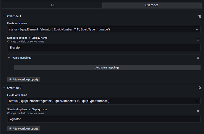

You can use overrides to simplify the display names, like this:

When building a panel, the queries are named (default is A, then B, etc). You can reference these query names in an override. You can also rename the queries to make them a bit more meaningful. For example:
Then, you can add an override for each query, and set the name of the result.
this way of doing it that you say does not work for me, could you explain it better, please?
