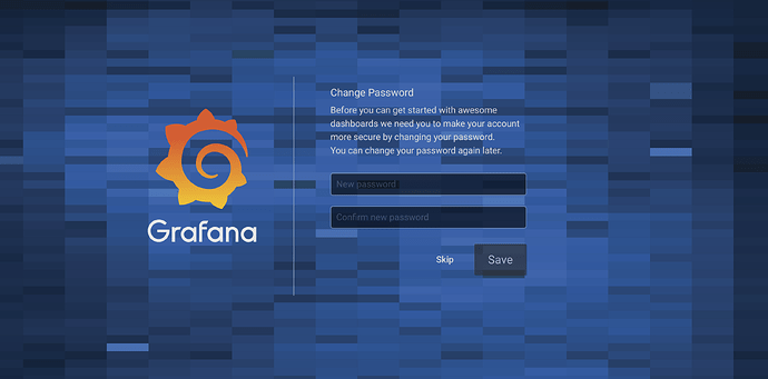

I have freshly installed grafana * v6.7.2 (423a25fc32) on ubuntu, on default first login when I try to change admin password it says error Unauthorised.

Then I tried to change the password, pressing “save” generated a red rectangle with the text “Unauthorized”. Pressing “Skip” throws me back to first login page, and by using admin-admin again I get the change password page and so on…
