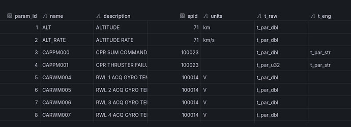

Some more info. Example of t_par_ref values:
