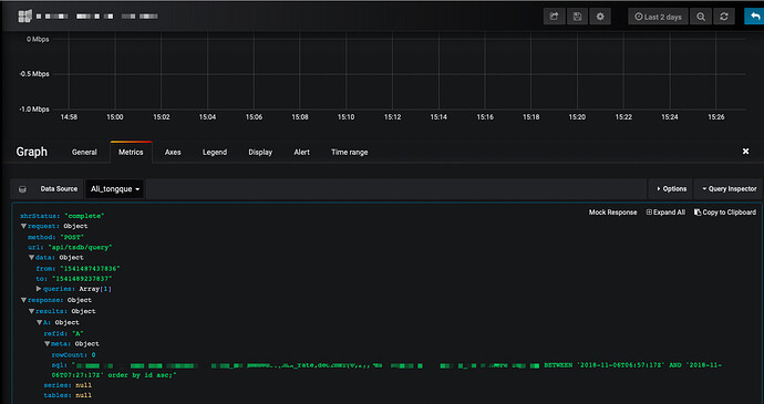

Using mysql marco $__timeFilter, $__timeFrom,$__timeTo in sql, and it not pase corrct,as the picture below.Is’t a grafana bug?

It seem’s not the same problem.I used quick ranges last 2 days but in the Query Inspector the time range is only about last few hours.I guess the marco didn’t correctly passed to this panel
Not caused by timezone problem.The time totally wrong
