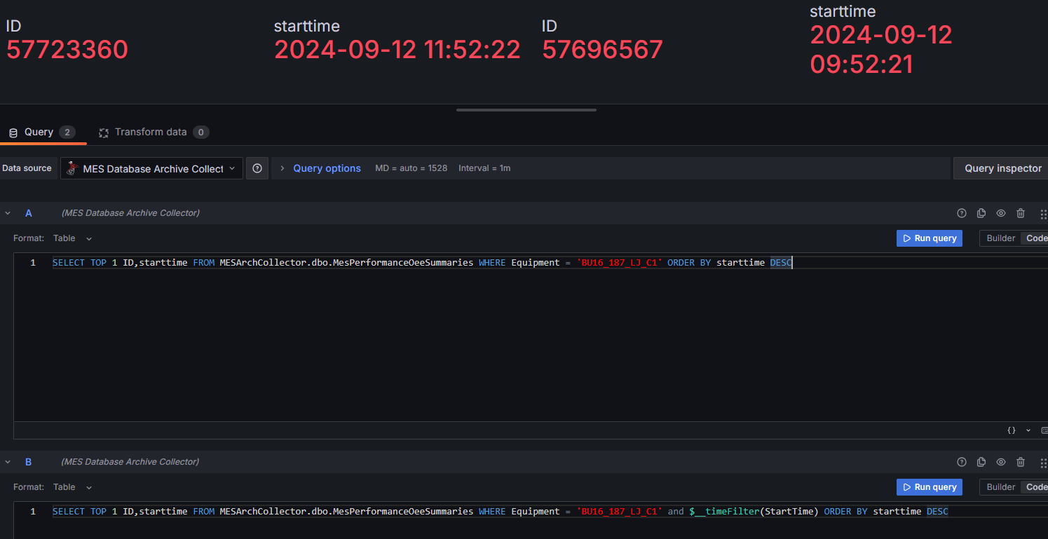

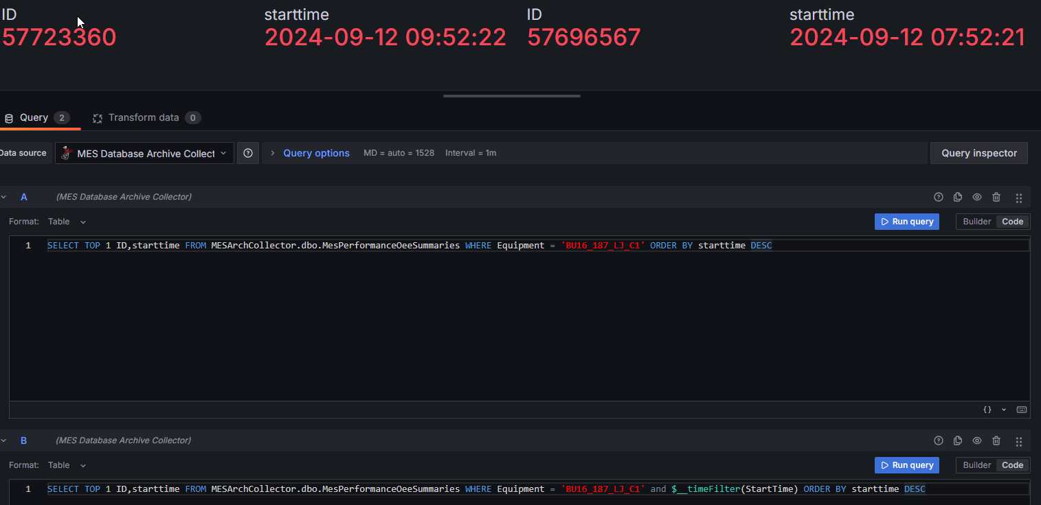

Here are 3 identical requests (except one where I add the $__timefilter()) and the results are not identical:
Request in MSSQL :
Requests in Grafana with UTC+0 :
Requests in Grafana with UTC+2 :
The correct result is obviously on MSSQL, but I don’t understand why the $__timeFilter() has such an effect on the result. It’s impossible to get the right result, and even worse when we just look at the date by applying UTC+2 in time zones Grafana makes us think we’re smme at the right date when in fact it’s only modifying the date imported from the database but not actually fetching the data at that date.
