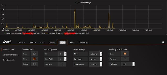

Hi Torkel,
Sorry for the late reply.
if you look at the graph , there are 2 servers, and it monitoring idel time, both of them has same idle time but one graph value starting from 100% and 2nd one starting from 50%
why both not starting from 100% ?
Thanks for the help
Hi,
let me try to put more explanation
if you look at the graph and the values under it, you will see
Yellow stack is for SVN
Green Stack is for Cpanel.
now they both has almost same idle time but SVN graph starting from 100%, where Cpanel graph (Green) starting from 50%,
should not they both start from same ? or is this because i using stack graph?
