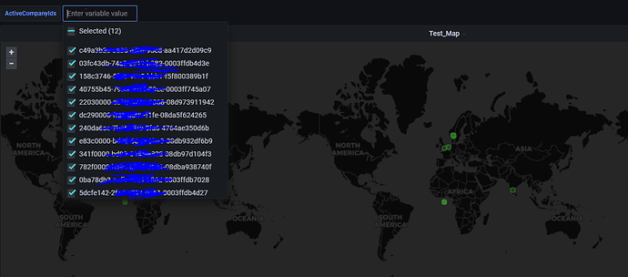

Thank you for the help! I did exactly what you said:
My question is - is there an option to have all of the ids selected all the time ? Thanks!

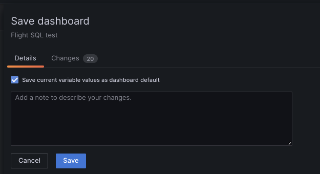

Select all and then when you save your dashboard, do this:
Thanks! But my variables will be different every time. Is that means this “save” will use them as static ?
Thank you!

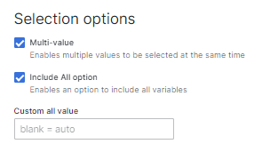

In the Variables set up screen, can you do this?
and then this:
Can the user change the selection once in a while or they must be all selected all the time?
That worked for me! thank you very much!
