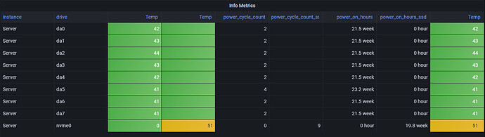

I’m using the Merge and Group by transformation on 6 queries(3 for hdd smart data and 3 for ssd), using calculate last or total on each queries and displaying it in a table visualization which looks like this:

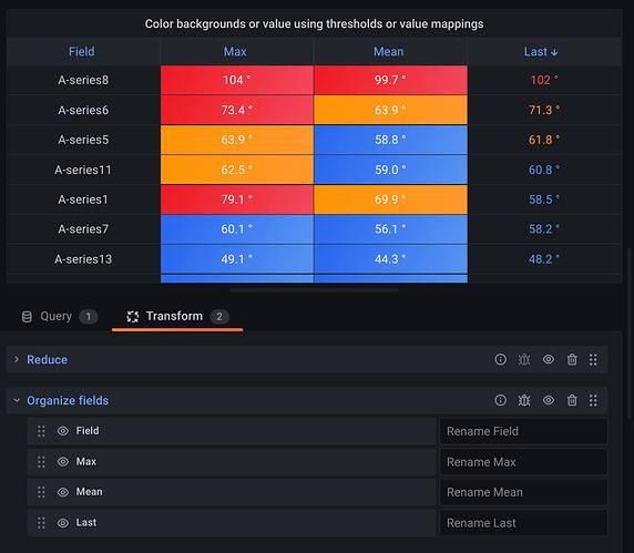

Have you tried the Organize fields transformation?

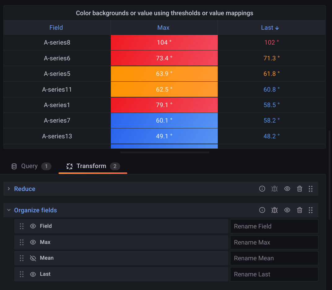

Example to remove the “Mean” column:
BEFORE:
AFTER:

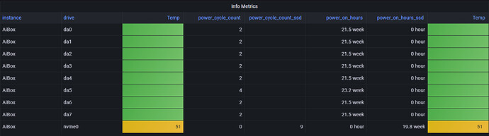

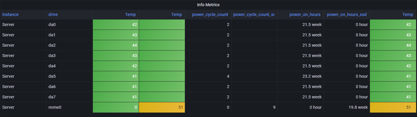

I did, this is what happens when I do(hid the hdd temp column):
If I hide both, then the merged column at the end disappear too.
