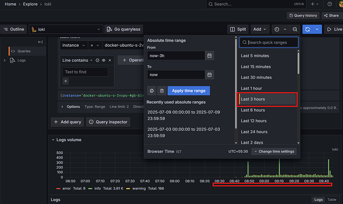

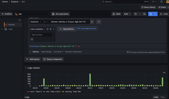

When we try time series visualization of Logs when Loki as Datasource, we get
graph and logs only upto last 2 hrs of timespan. If we increase the time range or use older time its not getting the data on dashboard. Also its not deleting any data from storage bucket older than retention period.

We should able to get the data on dashboard for atleast 24 hrs or for time whatever our retention period is. It should delete the older data from storage and retrieve all available data.

Yes this worked before and we were getting all the logs when using filesystem as storage in loki-config.yaml but when we started using digitalocean space storage buckets its started showing only recent 2 hrs of data. Also using the limits_config as given below the log retrival work for one time.
