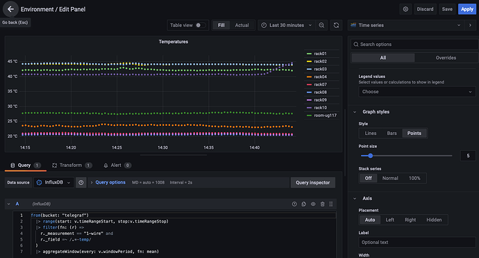

I am using Grafana 9.0.2 and since the upgrade from v8 I don’t see any difference between lines/points in the time series. The points are not connected anymore.
Here are the two options with basically the same output. Does anyone know why?
OK I just found out it’s caused by the last line |> aggregateWindow(every: v.windowPeriod, fn: mean)
but I need some aggregation, otherwise I get “too many data points” when I use large time windows.
What is the recommended way to do this kind of aggregation? I am still very confused about flux
(used SQL in Grafana 8).

ok I tried it locally and weird enough, I see your issue. what happens if you added this to the end?
|> yield(name: "mean")
but there seems to definitely be an issue as the time span reduces. bug!
and could you add this option to your aggregateWindow function ?
, createEmpty: false
And you can check this link too (there is work around to get fully connected graph) :
Ah thanks, createEmpty: false
did the trick. Do I need to yield the mean? I don’t see any effect other than the last datapoint vanishing
no in my understanding, yield is usefull for query with multiple output,
but added in simple query as a good practice
