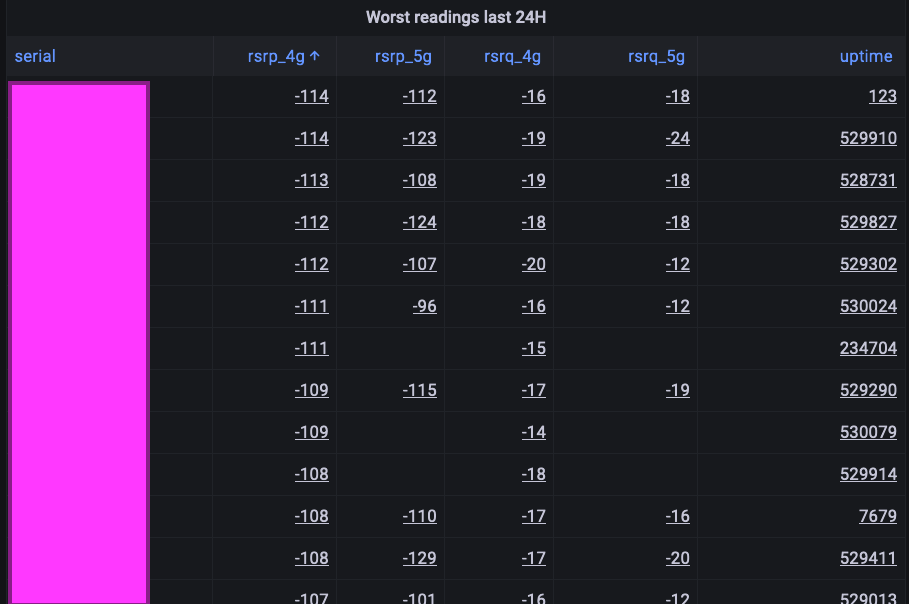

I found an workaround in the mean time by the way. By doing individual searches and using the merge transformation in Grafana I got the table I was wanting to build.
