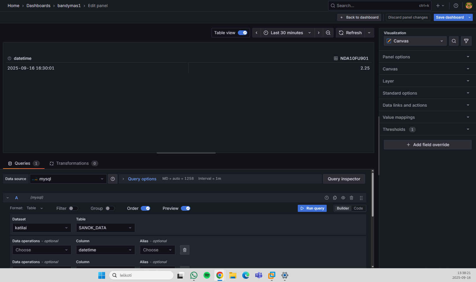

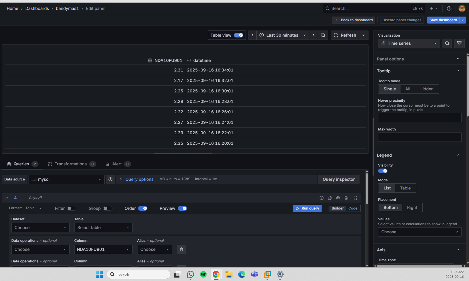

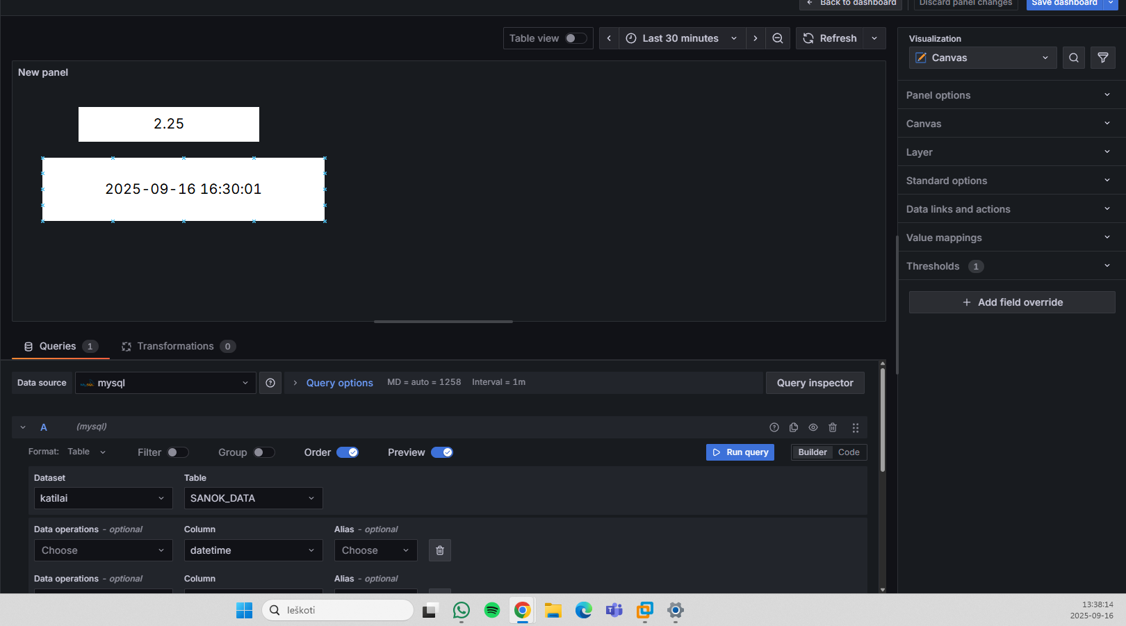

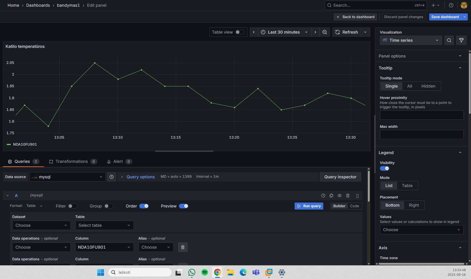

In my source, the time zone is UTC+3. I’m attaching screenshots of both panels. In the first panel, when I switch to table view the time is incorrect - you can see this by comparing it to my computer’s clock. But in 2nd - nothing changes.
When I change to UTC time zone in grafana, table views are showing correct time, but the graphics are not.
it’s better to change source to UTC, not have it as UTC+3
if not possible, try changing time series panel to xy chart with time as x axis - does it show time correctly?
