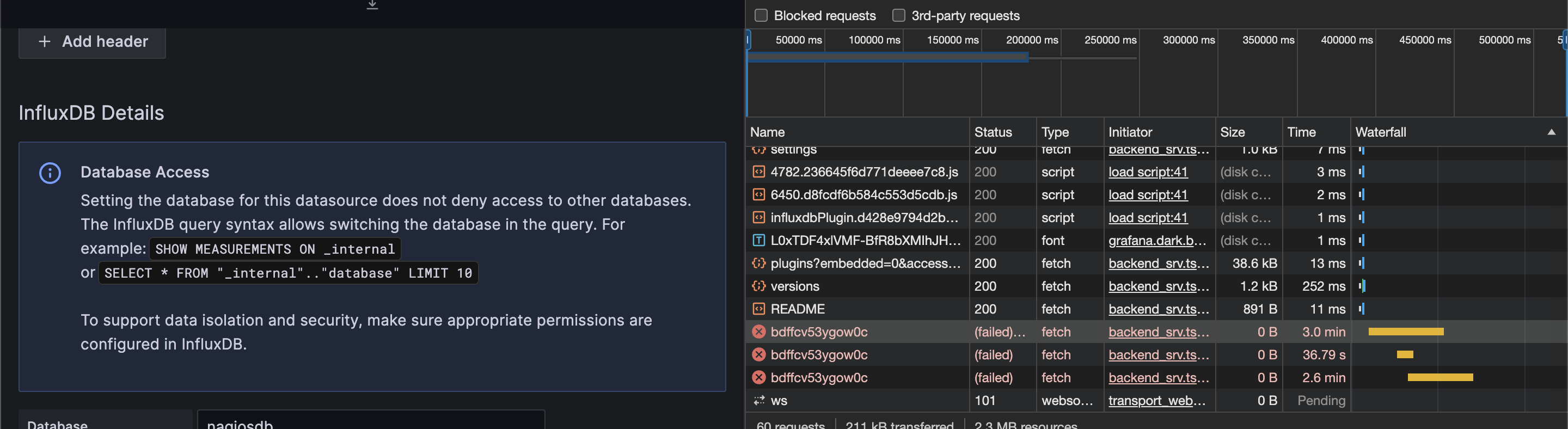

When I click on Save&Test, I monitored the website’s traffic through chrome.
In this screenshot, I pressed the button three times and there is three packets which failed named bdffcv*.
I will now try to install grafana on my mac instead of my centos server, and try if it could connect to my influxdb on centos7 successfully.
Pretty interesting…
I installed grafana again on my mac, and it connected successfully!
Is this a bug specific to CentOS? For I tried to install two different versions of grafana on my centos server, and also tried both on the machine itself and with docker environment. Neither worked.
