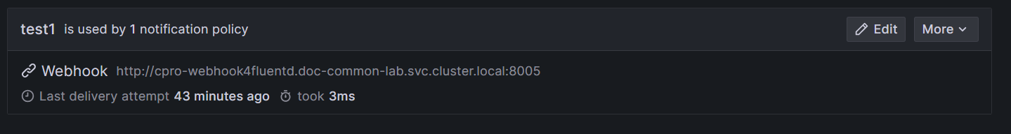

I have “test1” as the contact point …I could see the following in the Grafana Contact Page GUI
Last delivery attempt 43 minutes ago …took 3ms ..
Does it mean the Contact point is properly picked up by the Alert ? Also , my alert is getting fired every 5 minutes …Then why the delivery attempt shows 43 mins ago ?

This depends on how notification delivery is configured for repeated alerts.
The repeat interval is by default 4 hours. See here for details on notification grouping and repetition.
